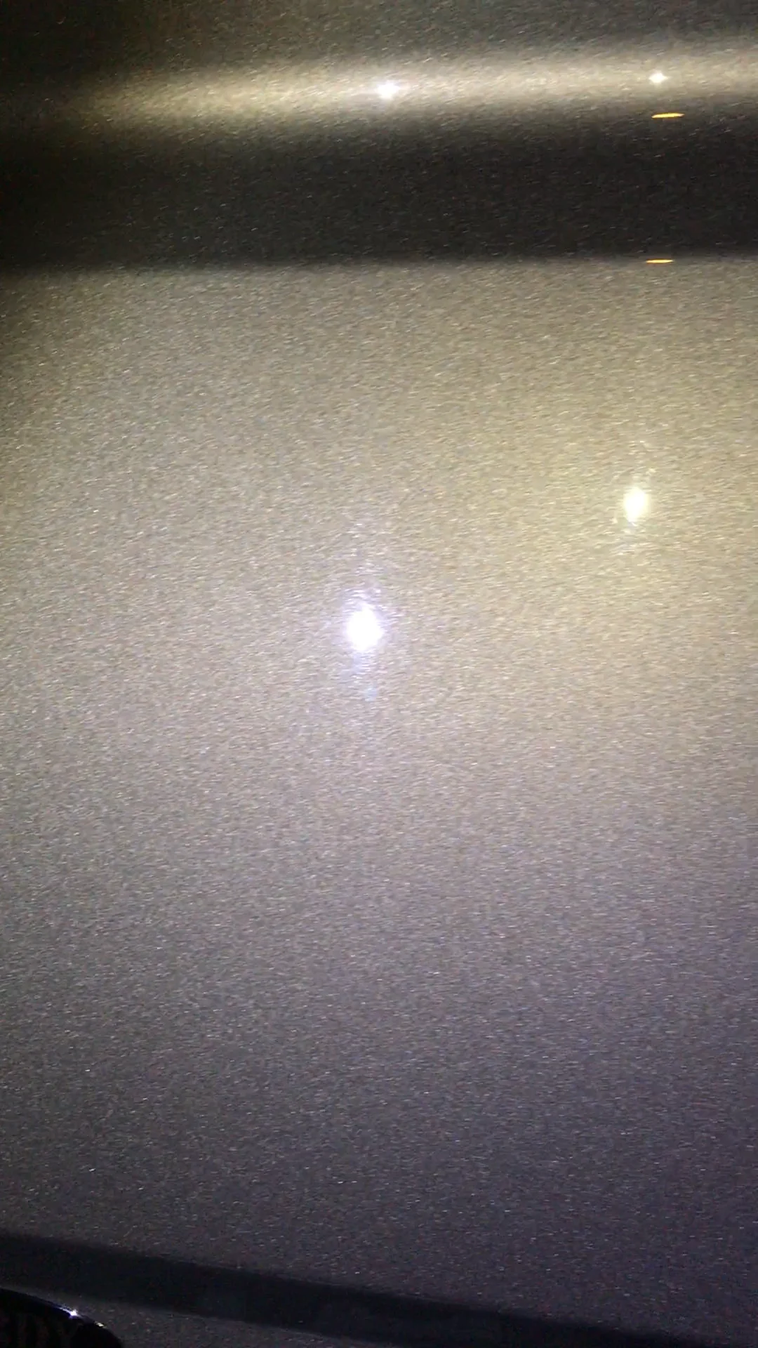

    Hey everyone, just joined this & it's my first time posting here. So, I have a 2014 silverado that's brownstone metallic. Has scratches everywhere, but they're light scratches, not bad. The hood and roof from what I've noticed so far has light etched water spots as well. I tested small areas with ultimate polish and it did well, but definitely didn't get all the scratches out. Then tried a small spot with compound & a follow up with the polish, and that was perfect. But I've had people tell me not to use compound on it. Just want to know what everyone thinks I should do? I will be using a Griot's 3" and 6" orbital with their orange correcting pads. Thanks in advance

    You have to use the product that will get the job done, which in this case is Ultimate Compound.
    You could also play with your technique, and the amount of product you are using with Ultimate Polish. I've had that product work miracles, but it totally depends on the paint..
    Did you try UP with the Orange pads? How did you dress the pad? What speed? How much pressure? How many passes?
    Old compounds were very harsh, and would scour the finish. The most popular compounds sold by Meguiar's do not do that. In very rare cases you might get a hazy finish, but it's easily cleaned up by M205 Ultra Finishing Polish, Ultimate Polish, SwirlX, or even M09 Swirl Remover 2.0.

                Just got enough time to start the correction process. I've done small areas on my truck, but this will be my first time doing this on the entire thing... don't know whether to be nervous or not about messing up the paint. Once again I will be using Griot's 6" DA as well as the 3" with the orange correcting pads and the MG's Ultimate line. What are all the steps I need to follow to make the best out of this? As in how many passes... DA speed, movement speed, how big of an area.. pad dressing etc.. Do I need to use Ultimate Compound for sure? Or will Ultimate Polish be just fine? Defects are minor, nothing major. Ive attached a video link of the defects on the paint to help out (be sure to watch in HD). Thanks in advance.

                  Test spot with ultimate polish and go from there.
