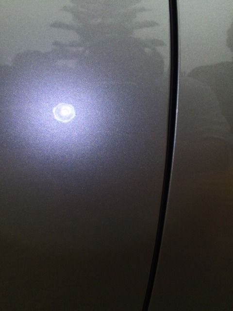

                      You're sorta right about little difference in gloss.. Only reason I say sorta is because I too did a test of similar products and found interesting results. I actually took a bunch of pics, and was set to do a huge write up but was swarmed with sidejobs and never ended up dedicating the time to post about it.
                      But here's the cliff note version..
                      Black wax on the left.
                      M205 center.
                      D151 PRC on the right.
                      M205 won.
                      Black Wax came in a close 2nd. Very close.
                      PRC sort of got left in the dust..
                      However, both M205 & Black Wax got the pleasure of being used with the new Megs thin foam polishing discs. While PRC was used with a LC Flat Foam Pad/White.
                      Both BW & M205 corrected well. M205 left the paint 100%
                      But PRC on the LC pad still had a signifigant ways to go... There's only 2 ways to call it. But I couldn't help to think it had to be the difference in pads.
                      Here's the only surviving pic I have of my test from that day. I had a bunch of detailed close ups of all 3 in direct sun to compare, but I ended up deleting them because I never got around to doing a write up.
                      Moral of the story.. Don't settle for swirls.
                        If it's swirl free then I say black wax for the more polishing benefit. If it needed minor correction somewhere then I would do black wax.

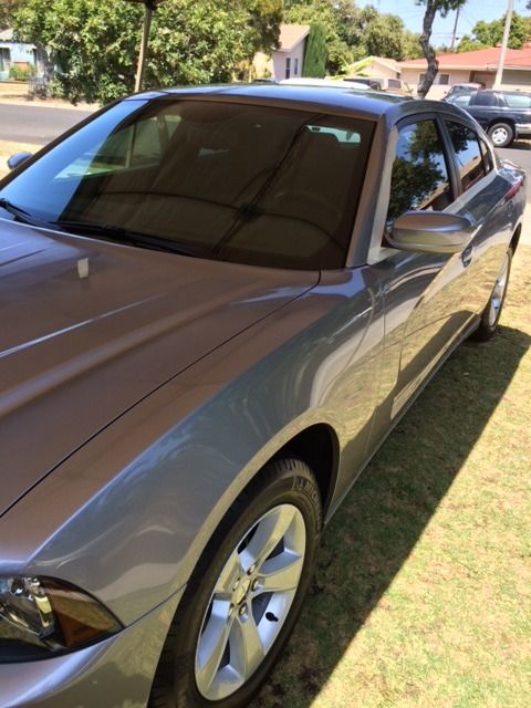

                            Here's a few pictures of the process & results w/Black Wax.
                            This is the car as it showed up.
                            Paint's in good condition. No swirls or oxidation.
                            But there were some contaminants for the clay to remove.
                            Spread the Black Wax nice and thin. Just like any other wax, the more you use, the harder it is to take off.
                            I had plenty of Ultimate Wipes on hand for easy removal.
                            Here's a shot of the side of the car just after removing the coat of wax. [hood still has layer of hazed wax on it]

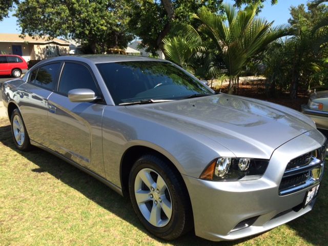

                            After photos. I used D4510 to make the honeycomb grill pop. Also used D115 as a final touch on the chrome.
                            Black Wax worked great. Smells good too. Customer was blown away. Lol. He said he'd never posted a picture of his car on Instagram, but he is Now!
                              Re: Which wax would you use?
                              Nice job. Instagram is always good. Could mean more clients
