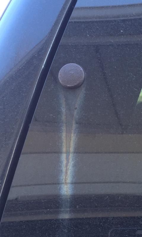

    How and what products should I use to remove this (rust?) stain from my rear glass?
    What have you tried so far?
    Have you tried to remove it with a claybar?
      Yeah.. I would go through the usual clay, ult compound, glass cleaner, RainX if you havent tried much yet.

        Could try out the Glass Science Glass Scrub

          Soak a paper towel in vinegar and stick it flat to the window. Leave it ten or fifteen minutes. Should do the trick.
