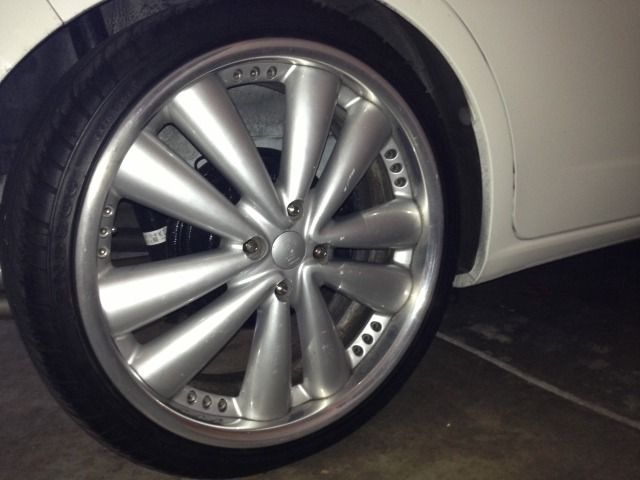

    I have an old set of wheels (14yo) that have a great deal if brake dust caked on the inner barrels and lip of the wheels. I have used meguairs all wheel cleaner as well as mothers and have been able to get some off. Looking for tips on how to completely remove it so I can paint and polish the face and wheels.

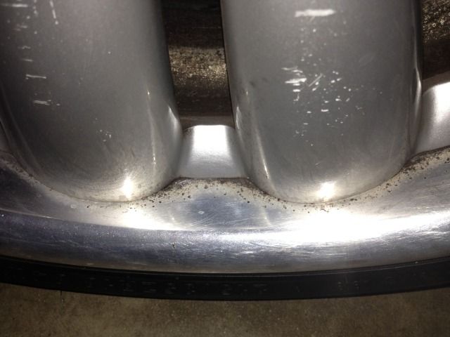

      Could I use a dremel with felt pads to get in there. Any polish or cleaners to use on the wheel. In the second pic you can really see how caked on the brake dust is the barrel.

            I can't tell if those are pitting or surface deposits?
              Re: Removing baked on brake dust
              They are surface deposits.
