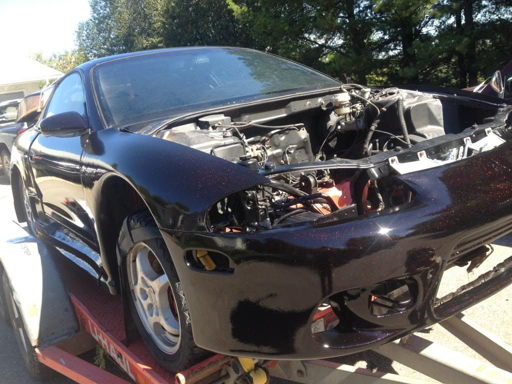

    Here's the car on the trailer after paint.

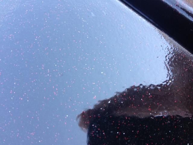

    Orange peel...

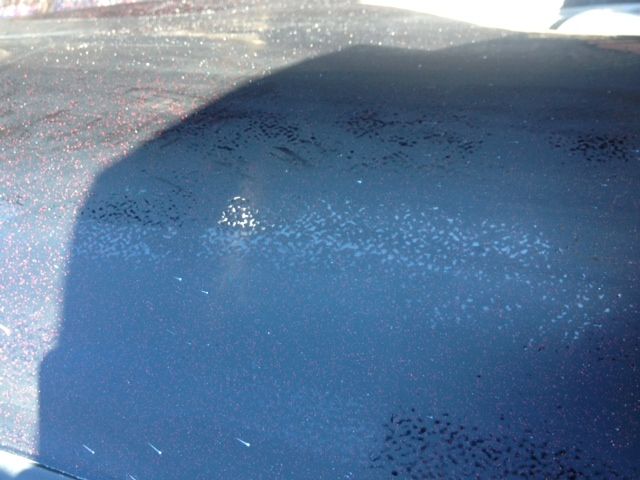

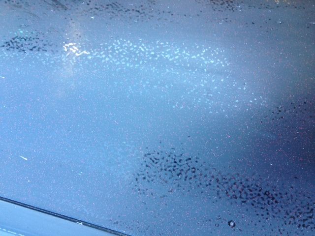

    The rear passenger quarter panel had the most peel, so this is what you see below after I have block sanded it and tried buffing and polish.
    I wanted to come to you guys and ask before going any further. But as you can see there are still some areas of glossy dots, this seems to me that they are still some low spots in the clear coat. So do you think I should keep sanding more?
    And as for the dull color, what do I need to do to get it to shine after sanding??
    I appreciate all help!!

    Yes, the glossy spots are low spots, so it needs a bit more sanding. You want the whole panel to look cloudy. You may want to go over the car with 2500 or 3000 grit to make compounding a bit easier too.
    Its definitely better to find a little shade to do the compounding/polish because it will be a little harder to buff off. (not sure if you want to spend the money, but i got a 10'x10' popup tent from walmart for about 90bucks.
