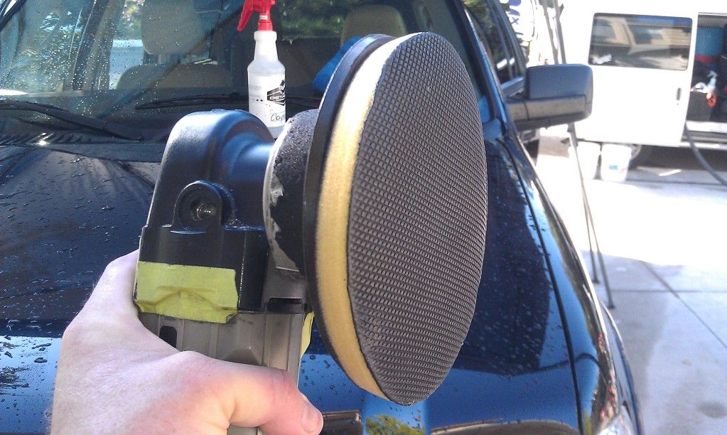

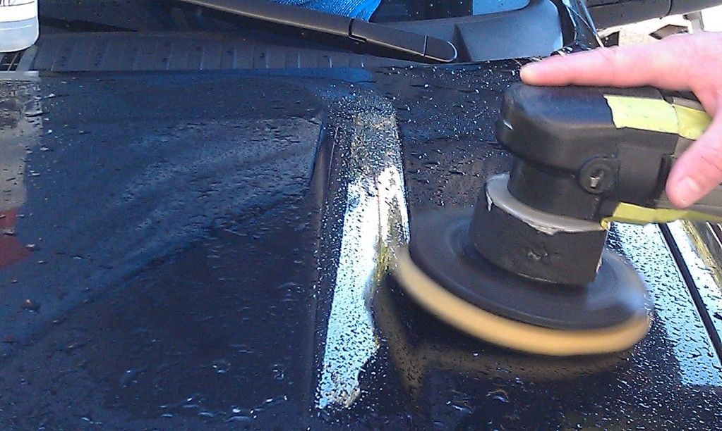

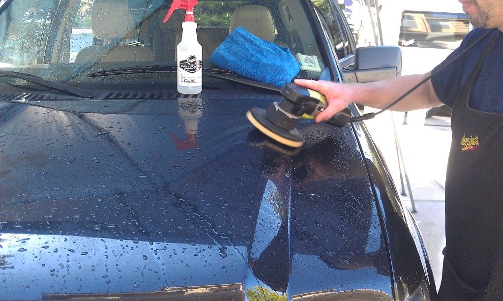

    so here are some pics of the autoscrubber

      Wow, I just did bunch of reading up on them and watched Joe's video and a few others too, seems like a great tool, especially for removing overspray. A couple questions for you since it sounds and looks like you have definitely added it to your arsenal.
      What the lube that you use to go along with it? In your picture it looks like a generic bottle, so just curious. Obviously its quicker and and saves you time, but it is a little more expensive than clay (although not too much), how many cars do you get out of a single pad, and has it replaced clay for you all together, or just on stuff like overspray? Finally, in the research I also found out about the Nanoskin Surface Prep Towel (which looks like the same technology, just in a towel form - and can be purchased through ADS) Have you used this one at all, and if so, how does it compare to pad. I am very much considering this as a possible way to cut down time on the paint cleaning steps without sacrificing quality. Thanks in advance for any further light you can shed on these.

        Glad to see you like it.
        I hate clay. I hate clay. I hate clay.
        With being said. Yes it's replaced my clay.
        I use water with a few drops of soap as a lube.
        they say you can get 50 cars out of these pads. I belive you can get more than that.
        I also have the towle and it comes in handy all the time.
        They also have a pad for you hand which I'm gettting soon.
        Rubber has been out for a few years now and I love it way more then clay.
        no srcathing like clay can and if I drop it I'm not out 10 bucks.
        I clayed this huge Exploer in about 45 mins. including the roof. with clay it would have taken twice as long and my arms would be wasted.
