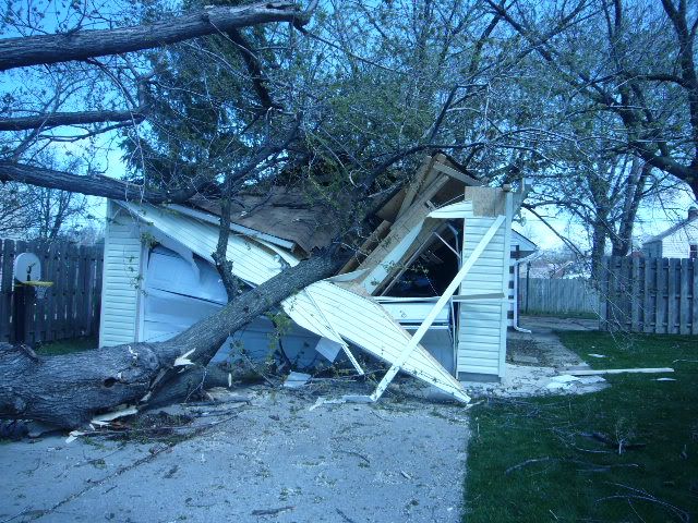

            I know exactly how you feel. I had a tree fall on my 1.5 year old 2 car garage, with both cars in it. My wife's car had minimal damage while had over $4000 in damage. The hood, front end and roof all took the most damage. I told the body shop mamager that I was very peticular about my cars. I asked for a tour of the shop BEFORE any work was done. This way I could see his employees at work, and see some of the cars in progress. I guess I was one of the lucky ones because I could not have been more pleased with the end result.
            Good luck and I hope your vehicle comes back good as new.
            This is what I woke up to last April.
