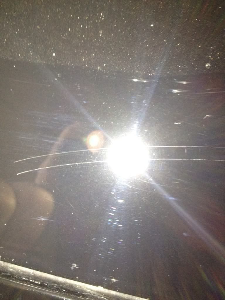

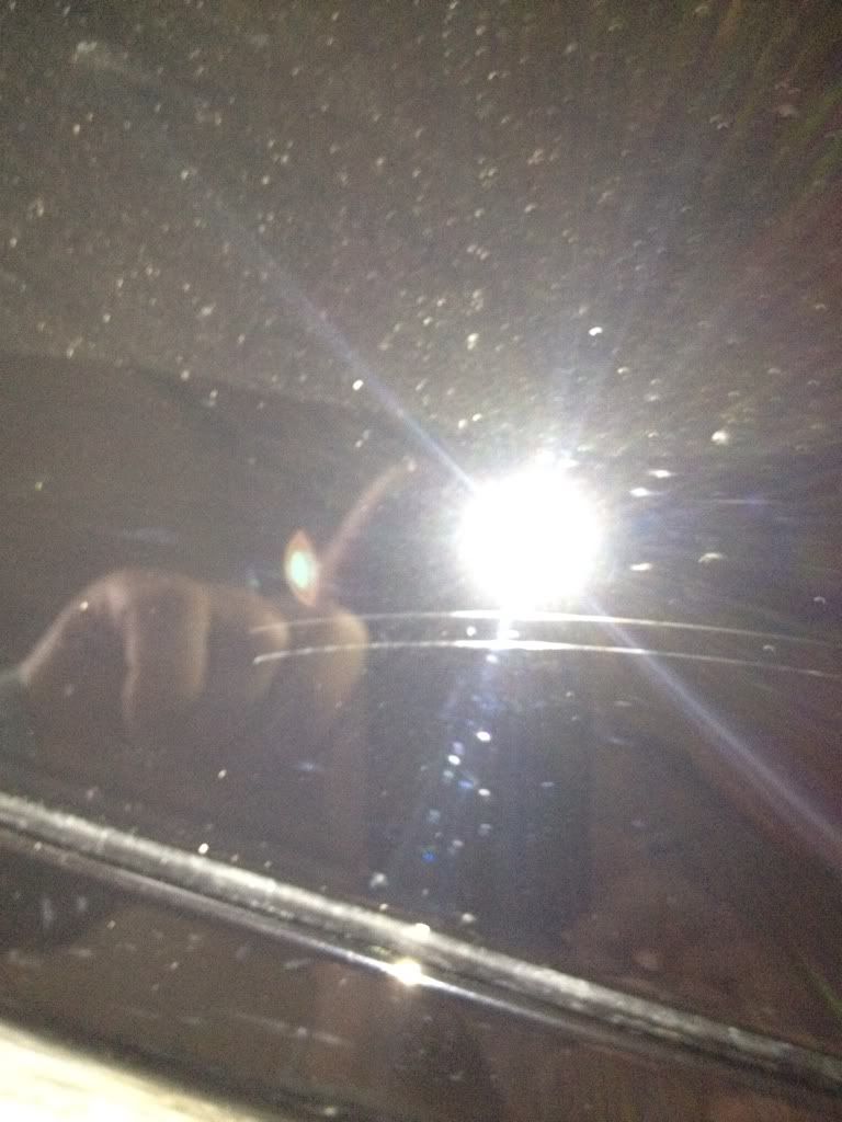

            Here are the pics I promised
              Re: removing stubborn fine scratches
              Those two bigger scratches you may not be able to get rid of, as they look quite deep - although you can probably improve them.
              The other cobwebs / swirls you should be able to correct with the right products / technique.

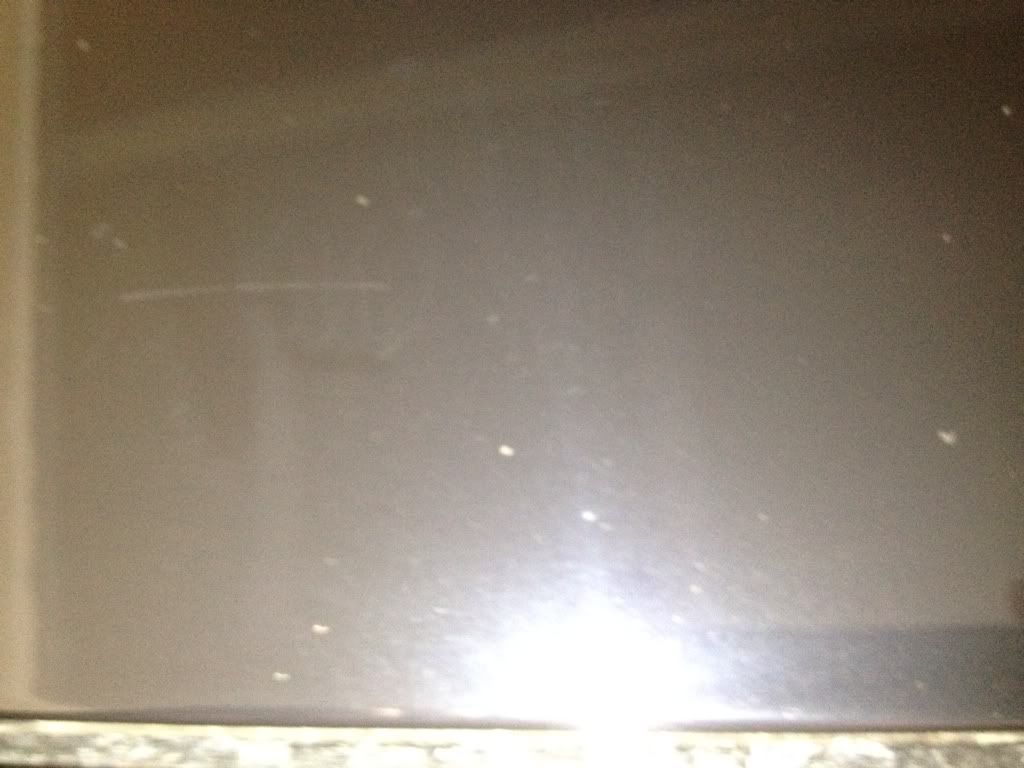

                Well I bought the mf cutting pads and they have already improved with 6 slow passes. Will this show an uneven coat now when I'm done since I will be more aggressive over the deeper scratches?
                So this is an after pic of the scratch after mf cutting pad and UC.

                    ..Speaking of which, you might want to call it done in that area now - UC on MF cutting pad is quite an aggressive combo! Looks good anyway, well done
                      I don't think I removed too much. It wasn't that deep. I couldn't even get a fingernail in there. I think it looked worse than it was. For some reason when using the foam pads I can't tell a difference in the correction but can in the shine. I'm just going to go over it with pure polish and wax now

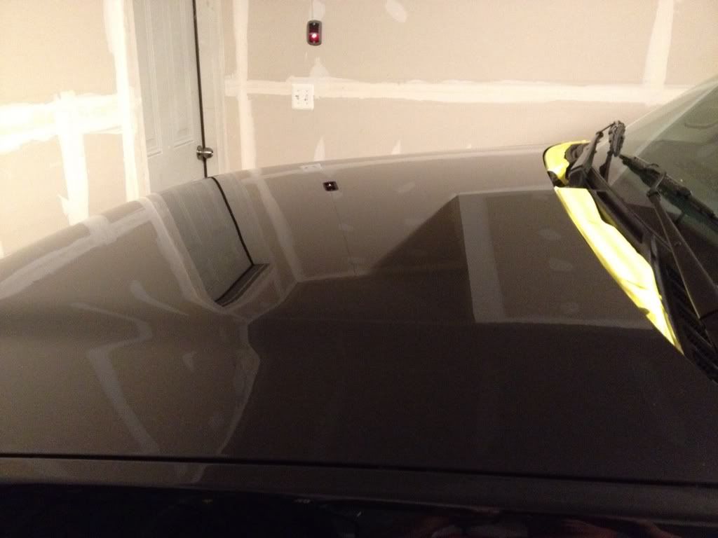

                          Ok mike I did the hood already with the UC and mf cutting pad and followed up with UP before I read this post just to test it out. I used alot of pressure and speed setting 5 for the cutting and moderate pressure and speed setting 3 for the polishing. Looks great right now. The final test will be in the sun. I will let everyone know tomorrow about the turn out. For some strange reason I do not benefit from the yellow pad when cutting.
                            This is how the hood turned out. Do you think I can get more gloss than this. This is after UP yellow

                              You might be able to get a little more gloss with something like #07 Show Car Glaze. You will also get some addition depth of color and reflection when you apply the wax -- probably go with Ultimate Wax for that color.
                              Alternatively (I haven't tried this, just a theory), you could put on some more Ultimate Polish and not really work it (maybe even do it by hand) and just let the polishing oils do all the work. You wouldn't need to be aggressive because you've already done your polishing step where you put the abrasives to work. Just wipe on / wipe off to maximize the amount of polishing oils you're getting on there.
