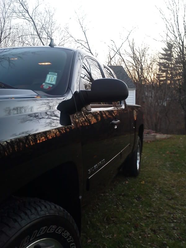

            ok today the lighting was a lot better
            so i took a few more pic
            not to toot my own horn, but....
            im pretty dam sure that this is as good, as good gets
            man i love black
