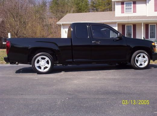

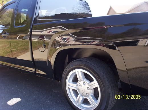

    Finally got a chance to use my 7336 on my Colly. I used NXT wash, #80 Speed Glaze, NXT Tech Wax x2, and wiped it down with Speed Detailer. Took me a couple of sections to get the hang of #80, but I think I got it. I had some light scratches from washing, some heavier scratches. The #80 removed all of them. I'm happy.
    Looks good! Deep looking finish.
    I am going to detail my truck sometime in the next week or two. I was going to pick up some #80 as well, I have never used it. Sounds like it worked well for you. Was the #80 easy to use once you got use to it? Any tips for its use?

          Was curious to what speed you had your 7336 set to for the 80 as well as the NXT. I have the G-100 which is really the 7335. Been using mine at 4.5 for #80 and 3.5 for NXT. My vehicle is 05 Focus ST in the Infra Red which I think shows slight imperfections about as much as black.
            Looks good, I used 5 for the 80 and 3 for the NXT. I also used an ultimate bonnot at 2 to remove the NXT.
              I know what you mean about having to get used to the 80. Took me a little while to see how much I could use. What I basically do is cut the hood into three sections. 2 sides and middle. I use a "star" of product for each. Usually go north/south East/west and then diagonal and then remove.

                    It took a couple of sections to get an idea of how much to use. After I applied it the area, I made sure to work it in. I made east - west passes and the north - south passes. I worked it until it was just barely starting to haze. I removed it with a MF towel.
