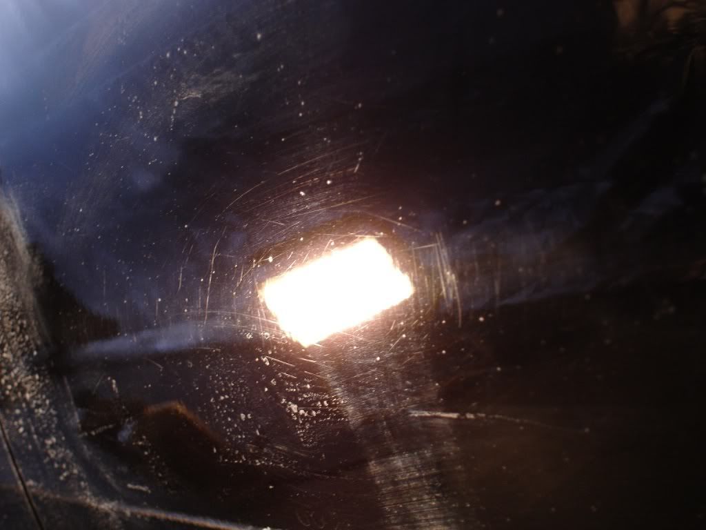

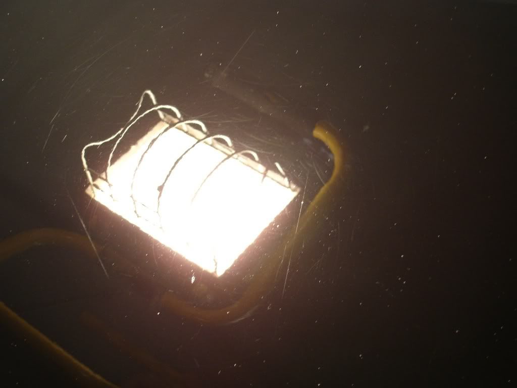

    Here's original paint on door
    Before
    After

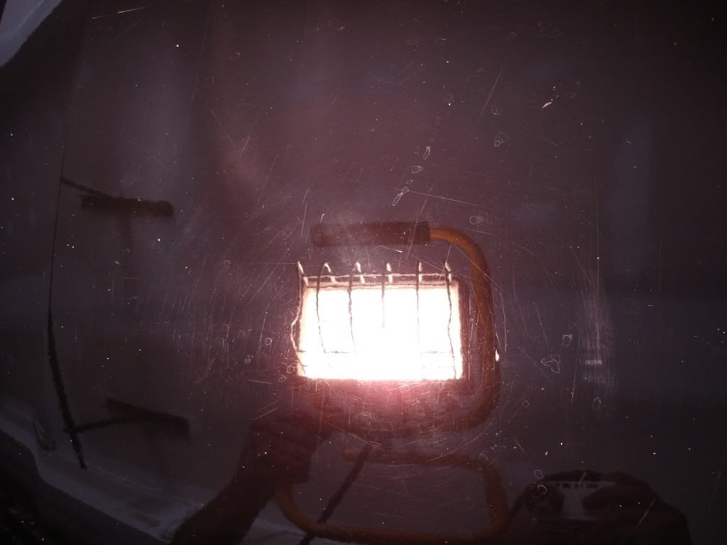

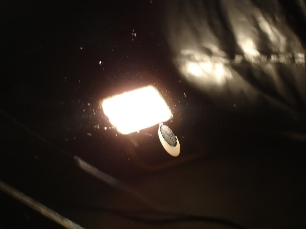

    And there's where I have problem with the hood
    Before
    After (2 times on yellow pad and M95, 1 time on wool + M95 and then 2 times yellow pad and UC)

      After wool pad, I get small spider web scratches, and with DA on yellow pad and M205 they remove, but if you look at the last picture this is the end result that I get. I can't get rid of those bigger scratches, though you can't really feel them with the nail.
