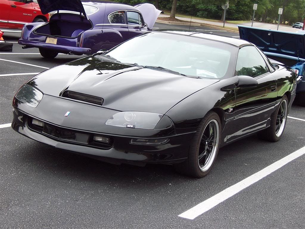

    Will the megs CleanerWax make a good base coat for NXT 2.0? I recently clayed and used CW on my car after 8+ years of washing every month or so.... Yea, the paint had ALOT of crud in it. Claying even removed some body buffing compound i found the body shop missed getting years ago. went so far as to dismount the spoiler and clean the area under that.
    Car at a show..
    Paint problem to cure..
    they lightly catch a fingernail as you run it across them. Can they be fixed without a repaint?
    100% Newbie at detailing.
    1997 Chevy Camaro Z28 Black..

    hmm.. not sure why it posted the images vs linking them.. silly software!
