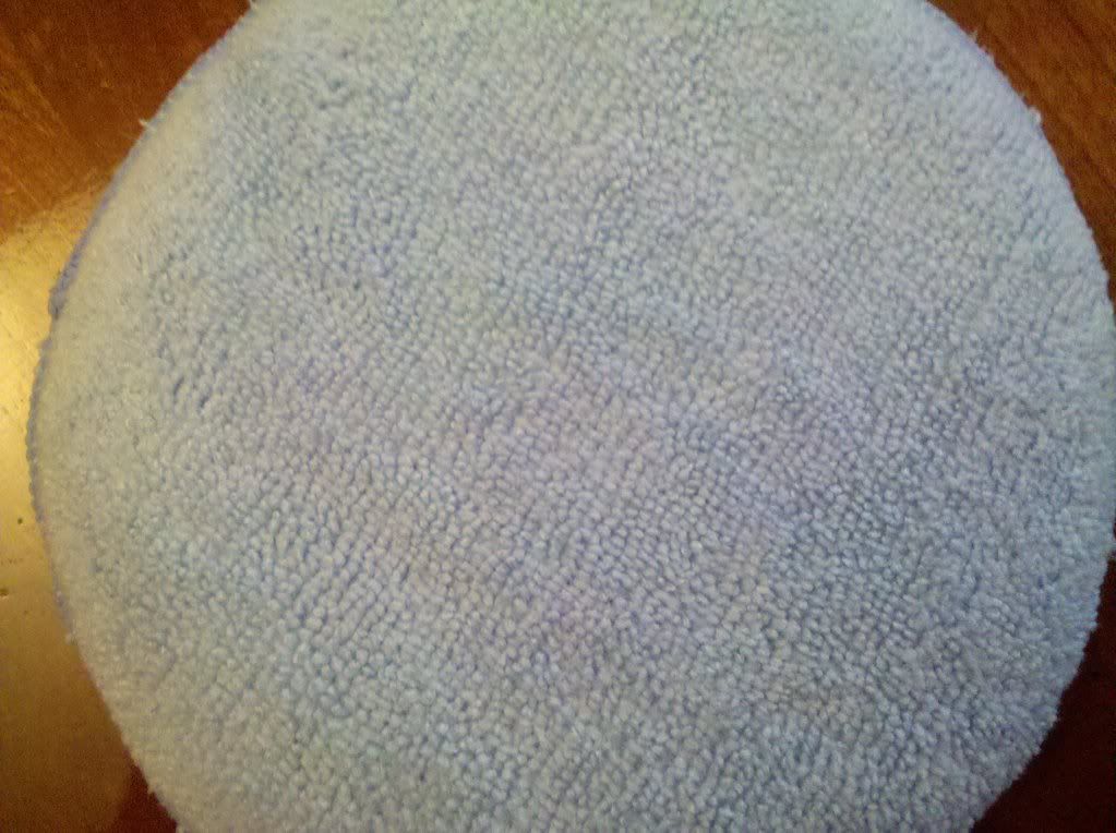

      What are you using to apply the product with? Terry cloth, foam pad, microfibre cloth?
      Do you have any pics you can post?
        Re: Problem: Swirl-X looks great until I wash my car
        Pad ^

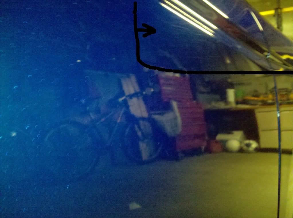

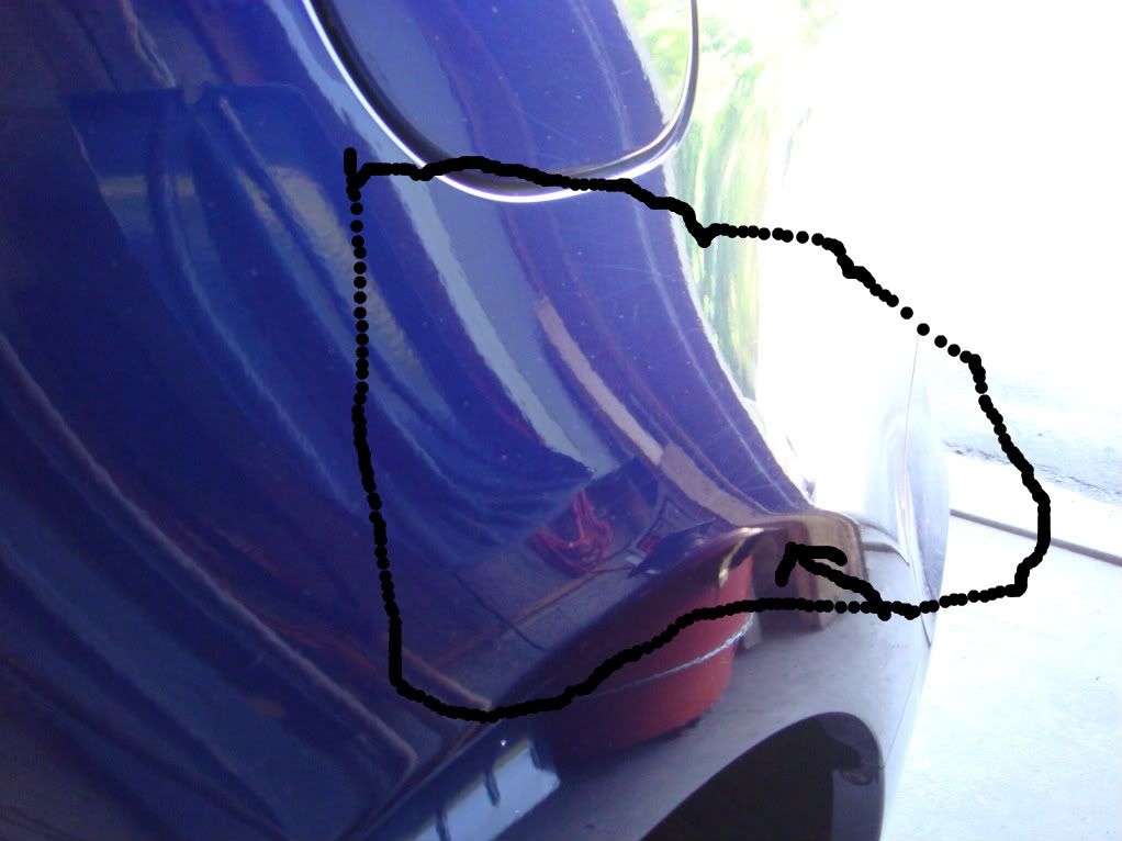

        This is a scratch my phone picked up. I have to charge my digital camera for real photos.
            The scratch in your first pic looks deep. Can you feel it with your fingernail? If you can, swirlx and scratchx will have a tough time getting it out. Also 5lb of pressure isn't a whole lot. Are you using a DA? Is that a microfibre bonnet in your first pic? I know you said you'd tried by hand, but was that after machine application?

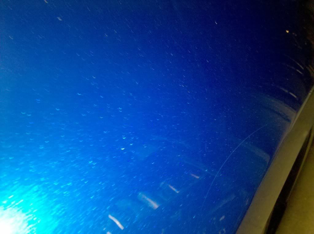

              These are the kinds of imperfections I am trying to eliminate.
                This may help,
                In our experience with this make/model the paint is incredibly soft and delicate. We don't like to make broad generalizations about paint hardness, but the newer Honda Fit and Civic models do seem to be routinely painted with very, very soft paint. We highly recommend staying away from terry cloth towels when working on this paint.
                Working by hand with an aggressive product like Ultimate Compound can lead to some issues if you aren't extremely careful about application process. But then again, UC is probably just overly aggressive for this paint. Your orbital buffer may well be sufficient here, but we question the quality of pads available for it. Try using either a foam or microfiber pad with just a small amount of ColorX or SwirlX and test just a small area on the hood - no larger than maybe 2' x 2' - then pull the car out into direct sunlight and critically evaluate it. ColorX is an all in one cleaner wax that we've seen do great things on the Honda Fit while SwirlX is more of a dedicated cleaner only and a wax will be required after using it.
                Just go easy on this paint. It should correct quite easily. Unless you attack it, in which case you'll be inflicting a whole new set of defects while taking out the originals.
