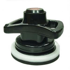

    I also have a Titan 22610 Random Orbital Polisher/Buffer

    The orbital is probably not going to be up to this task as you've got some serious issues here. It may make it look a bit better, but we have serious doubts it will take the paint to the level that can be reached with a G110v2 or a rotary.

        Why don't you try a 1ft x 1ft section by hand using your favorite product such as M105 or UC? If that gives you acceptable results, then you start looking to automate that process. If I were in your shoes, and if manual results were good enough, I would use the tools that I already have and see if they work. I have personally used the equivalent ghetto buffer from HF (there are few others who have done the same) with the same bonnet which comes with the buffer and it made a tremendous difference in finish of the paint. All my cars are at least decade old, so I have lot more leeway.
