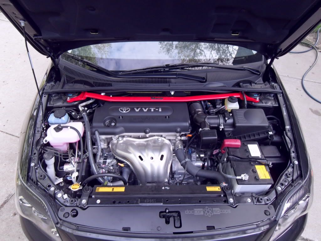

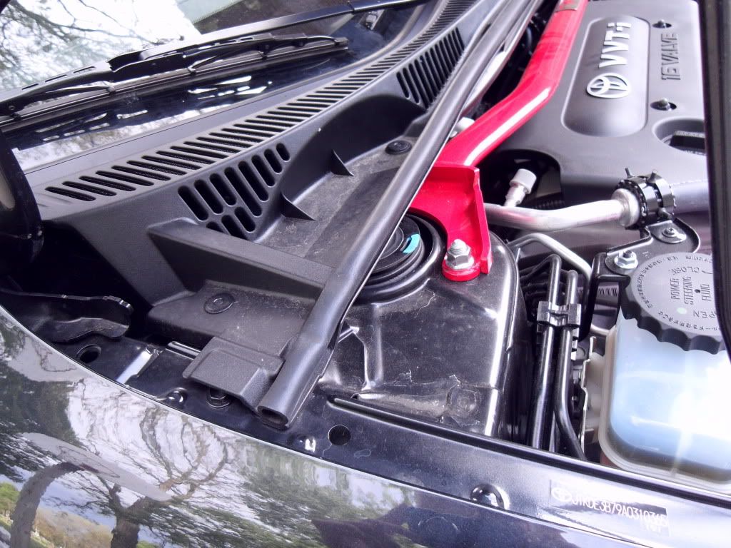

    I decided to work on the engine bay first.
    Here are a few before photos.
    My first step was to lightly spray with my firemans nozzle over the entire bay.
    The next step was to spray a 1:4 dilution of APC over the entire engine bay and scrub with a small brush.

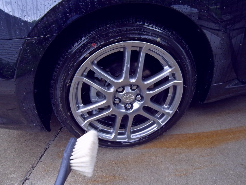

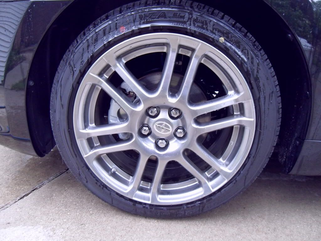

    While that was setting up, I got started on the wheels.
    This is a picture of them before I started.
    I first, sprayed them down with water, then followed up with a solution of APC 1:4 over the wheels.
    I agitated the rims like so
    And got around the lug nuts with this little guy
    I rinsed the wheels off and moved onto washing my baby.

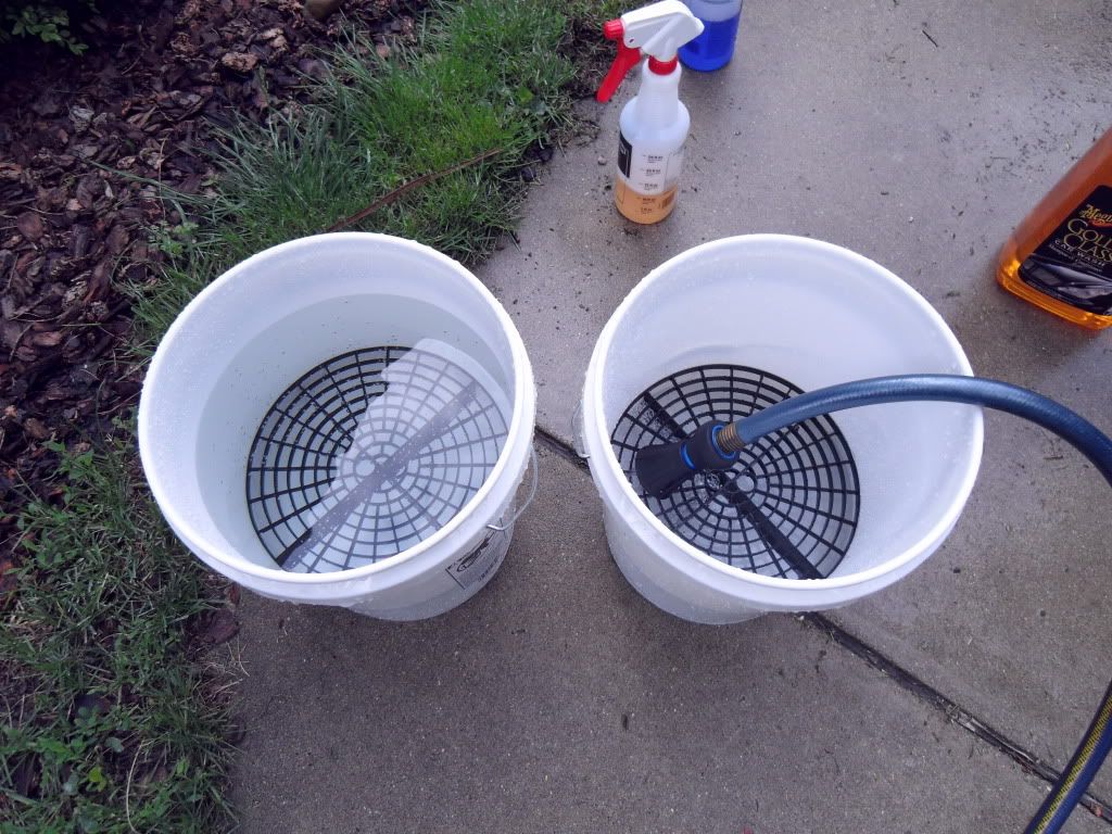

    Two buckets, grit guards in both. I'm very glad that I chose white buckets, You can really see if there is any dirt in them, to ensure that you have a clean start. I used a mothers lambs wool wash mitt, and Meguiars gold class.
    I filled the buckets up with water, and then added in the shampoo, as to make sure to get my dilutions right.

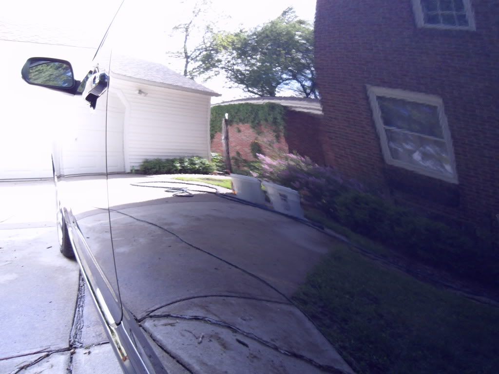

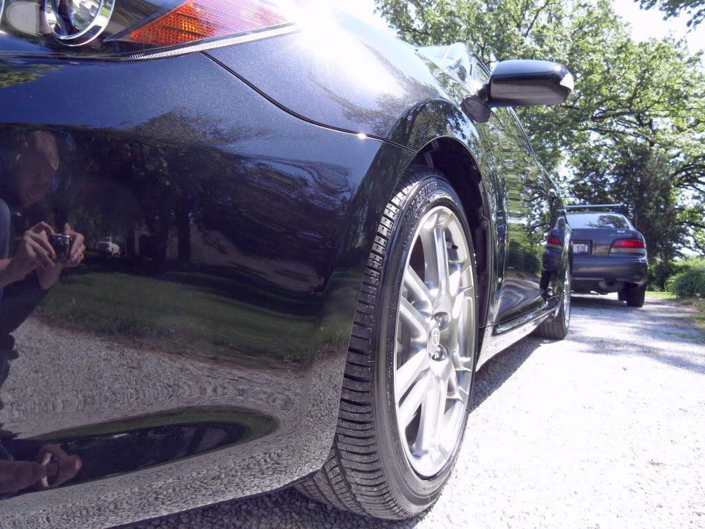

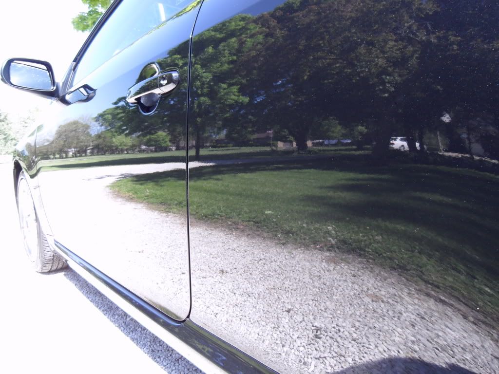

    Here are a couple, after wash pictures.
    I really liked the gold class shampoo. That along with a quality mitt really gives you the confidence to wash your car without adding any swirls into the finish.

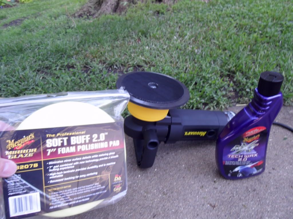

    On to my first experience with the G110v2

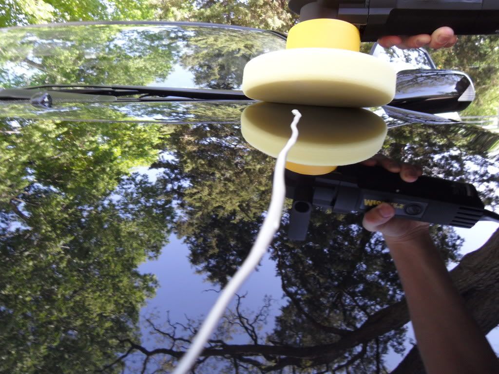

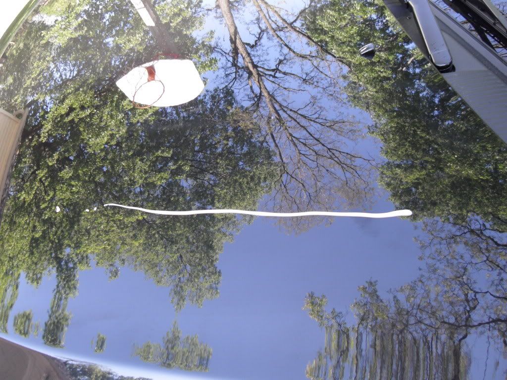

    This was my plan of attack, on setting 3
    I prepped the pad

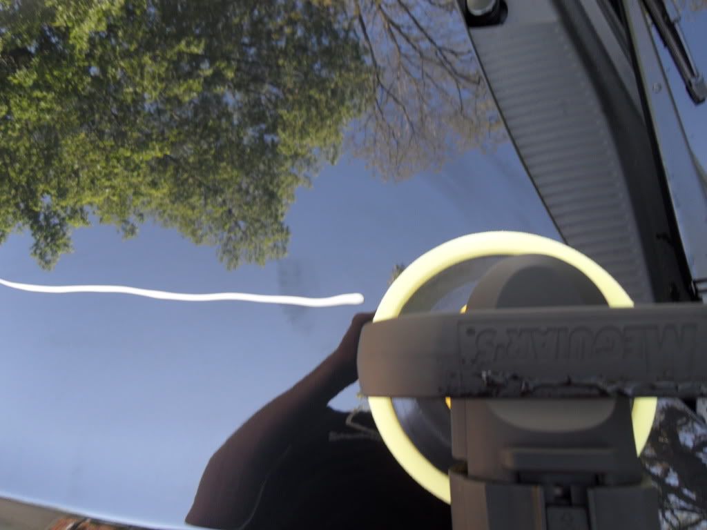

    And then did a quick pass as a test spot.
    After that seemed to work well, I laid a line and went too town.
    One thing I noticed, was that the pad never really seemed to be very saturated with the NXT 2.0. I always felt like I didn't have enough product. Is this the natural way the product behaves?

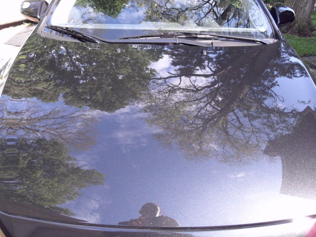

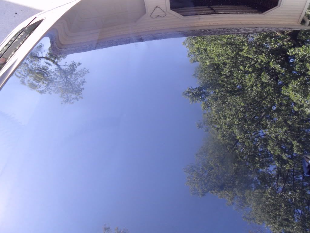

    I waxed the whole car, removing the wax after 15 minutes dry time. Wipe off was a breeze.

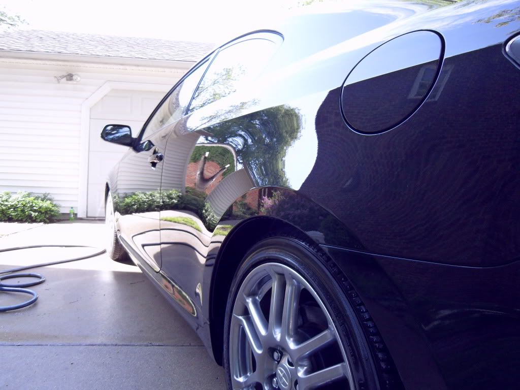

    I couldn't tell much difference in appearance after the wax, as the car is brand new anyway. But I wanted to know that I had the protection.
    And that was it.
    I applied some All Season Dressing too the tires, and admired my work.
    Over all, I spent 5-6 hours. But I nit picked, went slow. And made sure I did a good job.

    Nice work Paul, the car looks awesome The paint, wheels, tires, and engine all look great. I enjoyed the writeup as well.
    Next time you may want to try applying NXT 2.0 with a W9207 foam finishing pad, the finishing pad will tend to glide over the paint a little better and you will not have to apply the product as much. They pretty much spread out waxes and sealant a little nicer than the W8207 foam polishing pads.

        Is that the purple pad? I can't remember just what I have, but thank you. I'll certainly have too remember to get those if I don't have them.

          Here you go:
          SoftBuff 2.0 Finishing Pad - (7”)
