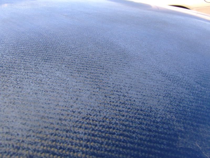

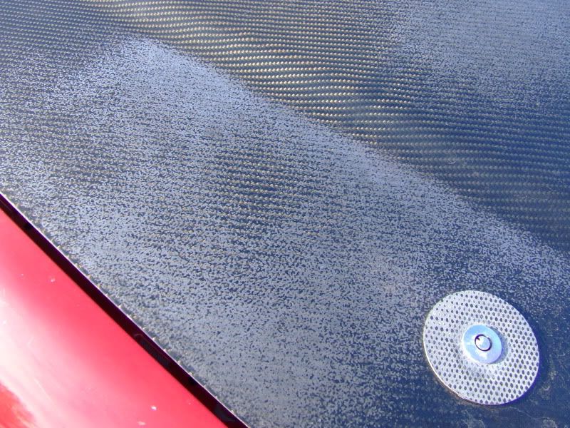

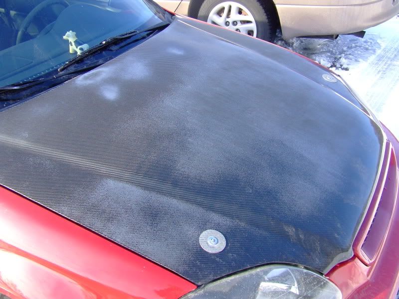

            Thank you for your replies guys! Pictures? Sure:
            The oxidation/wear, upon close inspection, does not appear to have worn through to the actual carbon fiber, but looks pretty bad as you can see.

              What "brand" is that CF hood.....
              High quality aftermarket companies tend to have a good clear coat........but if you got say a "china knock off" or a "ebay" hood odds are there wasn't much clear to begin with. I sell these tings on a daily basis and have seen the results, with carbon fiber alot of time you get what you pay for as far as the quality is concerned

                I would tape off a section of the hood and start polishing with a mild polish like Swirl X and see what you can achieve.
                If thats not working you can always step up to something more aggresive like Ultimate Compound.
                By the looks of things and the state of the hood it can only get better IMO.

                    Update: there does not appear to be a brand name on the hood. I can get a picture of the underside of the hood if that would help.
                    Is this clearcoat failure? If it's not oxidation, then I'm going to have to completely remove the clearcoat and have a new one put on, correct? I see where people say to just 'paint over the failing clearcoat' but I would imagine the continued deterioration of the CC would make the fresh paint on top of it to flake off as well...?
