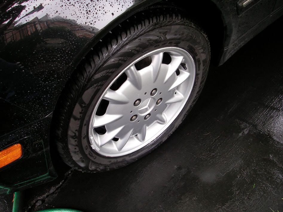

    Started with a rinse, and on to the wheels
    Before
    After

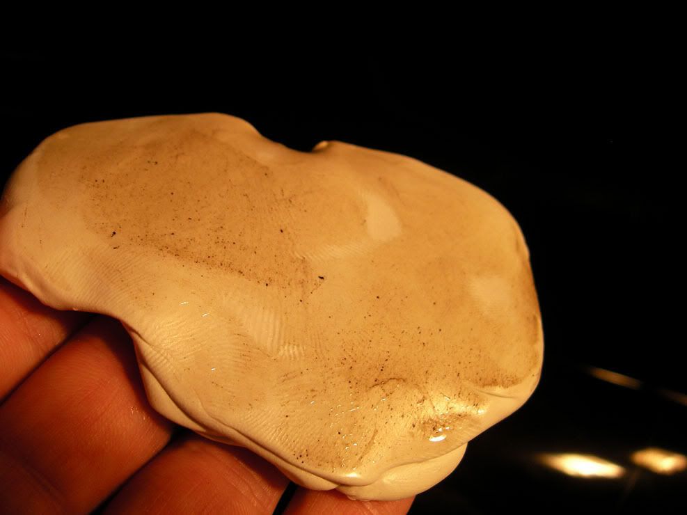

    On to claying… Most of the car wasn't the bad.
    Only bad areas were below the trim on the sides behind the front and rear tires.
    It felt like sandpaper over these areas. I had to kneed the clay about 3 times before the area would come clean (still wasn't 100% smooth). Maybe some more aggressive clay would have worked better?

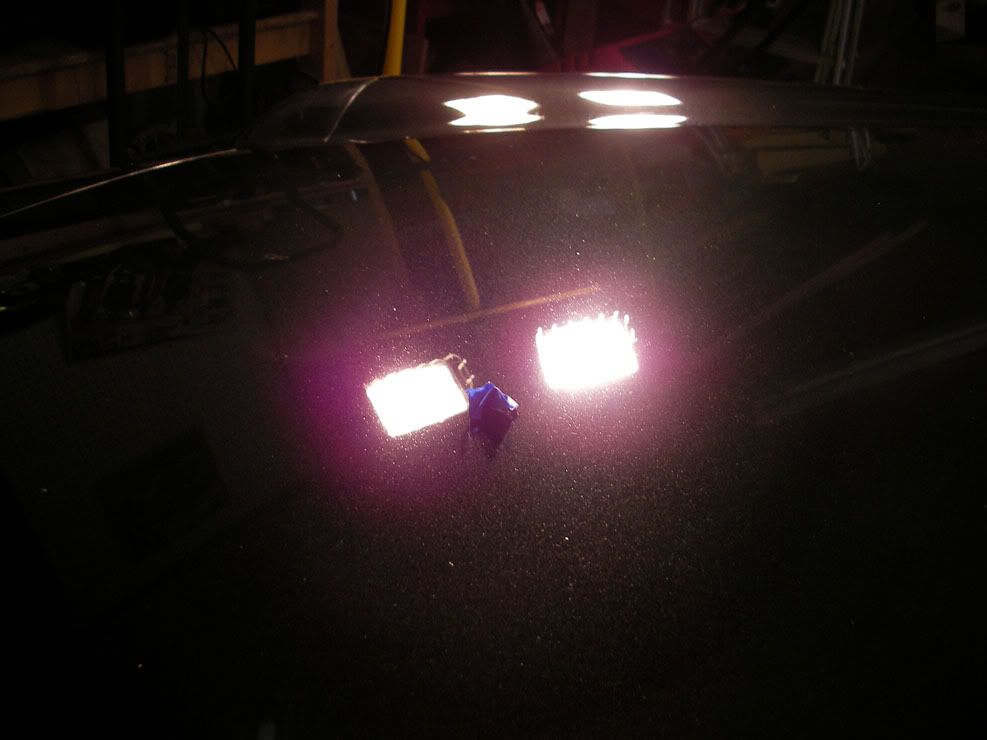

    On to the paint condition…
    Mostly light swirls, some deeper marks in some areas.
    Here's a picture of the CC failure on the hood

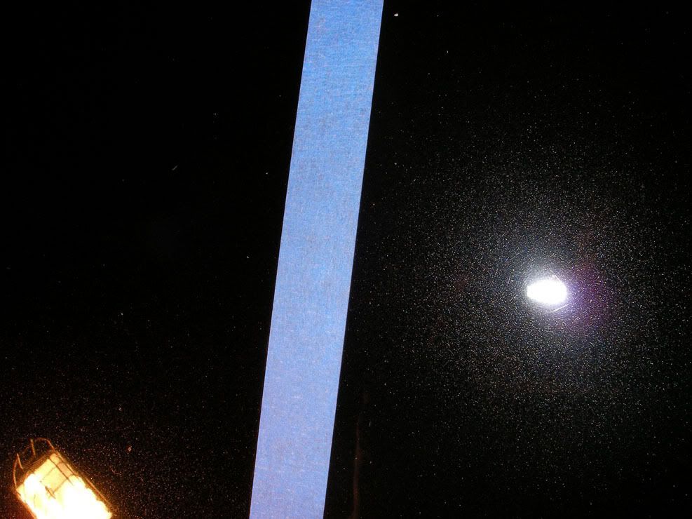

    Test spot taped
    I started with D151 since I wanted to try a 1-step, and have the wax as a safety net just in case I don't have enough time to put NXT on.
    Here's after D151 (on the right side)
    Some light scratches still showing through.
