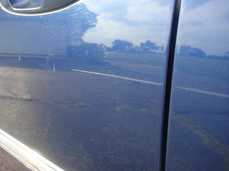

    I own a Hyundai Sonata 2003 GLS and it's in pretty good condition. Since owning it, the only damage I have done is put two decent sized streaks on the drivers side door, which extends to the back door. They look like scuff marks, but go a little deeper into the clear coat. I believe it happened when I was backing out of my garage and marked it up against a garbage can or bike. Oops. There are also some bird etchings that I know exist on here, but I didn't take pictures.
    Here are some pics.

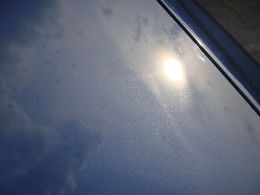

    Swirling (Wish I would have taken pictures on a better day when it wasn't so overcast in better lighting, however you can see some swirl effects are present):

        It looks like your Hyundai has some paint transfer and by the looks of it, it may be shallow and fairly easy to get rid of.
        First off give your car a good thorough wash with a quality car shampoo (NXT, Gold Class, ect), dry off with clean towels (water magnets work great) and then clay the car using Meg's clay & Quik Detailer.
        Some of the things you may be looking for are paint cleaners such as the Deep Crystal Paint Cleaner (if it can still be found....they are phasing them out in the states), if not try some ScratchX and if that doesn't work then the Ultimate Compound may be your best bet. Apply a small amount (I'd go with 2 or 3 pea sized dots) on a foam or microfiber applicator and go at it with some passion (pressure) for about 45 seconds. Wipe off with a clean microfiber pad, evaluate the defect and follow up with another pass if needed.
        After that you can try to knock out other defects and finish up with some wax. Look around here, you WILL find everything you need to do the job right and don't hesitate to ask questions. The pro's here are just that PRO's! They will square you away as they've done to me!

            Well, here is what I would do... And keep in mind that while a G110 is good for swirls, it may not have the power needed for the deeper marks. You may find it better to attack the scratches/rubs by hand, at least first.
            I would probably:
            1. Wash
            2. Clay - Smooth Surface Clay kit, and an extra QD bottle. Don't forget to clay the windows as well.
            3. Clean - Those deeper marks/rubs will definitely want Ultimate Compound or #105. Both can be used by hand or machine. And like I said, you probably want to work on the individual marks first by hand. Some defects may not be completly removable, so dont over do it.
            Then, you can decide if you want to use a machine for the swirls, or keep working by hand to do the whole car. As far as the swirls on the whole car, you may want to do a test spot to see if you need SwirlX or Ultimate Compound for them. You will definitely want SwirlX in the future for regular cleanings though, so with UC and SwirlX on your shelf, they wont go to waste.
            If applied properly, UC should leave a nice finish behind, but it is possible it may need followed up with SwirlX anyway for great results.
            Of course, don't go removing all your swirls by hand, then by a G110 the next week.
            4. Polish - Using a pure polish is optional, but Deep Crystal Polish is good and easy to use.
            5. Wax - Nxt 2.0 is nice, 2 thin coats is best.
            Other Q's:
            1. ColorX is a great product, esp for a quick detail, but not really want you want for major defect removal.
              Haha, I think you're seeing some old dirt/reflection from behind me. There isn't any paint transfer from any accidents that I've had.
