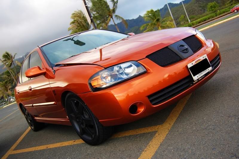

    Let me start out with some basics. My car will be featured in a calender used to support a local website. I purchased the car with 8k miles on it and factory paint. Since then (26k miles). I have taken care of the paint. Washed every week, touched up with QD when it needs it. Then every 8 months or so I clayed, scratchX, polish, wax'ed it by hand. The paint is in what I would call good condition (i.e. minor swirls and defects). My question is should I detail my car by hand again or buy a G110 and use that. I have no experience with a DA but am a fast learner. I feel confident about doing it by hand, but I want my car to really shine and hopefully cut down on the time it will take me to detail it.
    Now if you say G110, what chemicals/pads do you recomend? I was looking at the G110 package that came with m205, 80, nxt 2.0, pads and clay.
    Here is a pic of my car about a month before I stored it- resized to 800x600
    Let me know if the pic doesnt work, I am at work and cant see photobucket pics
