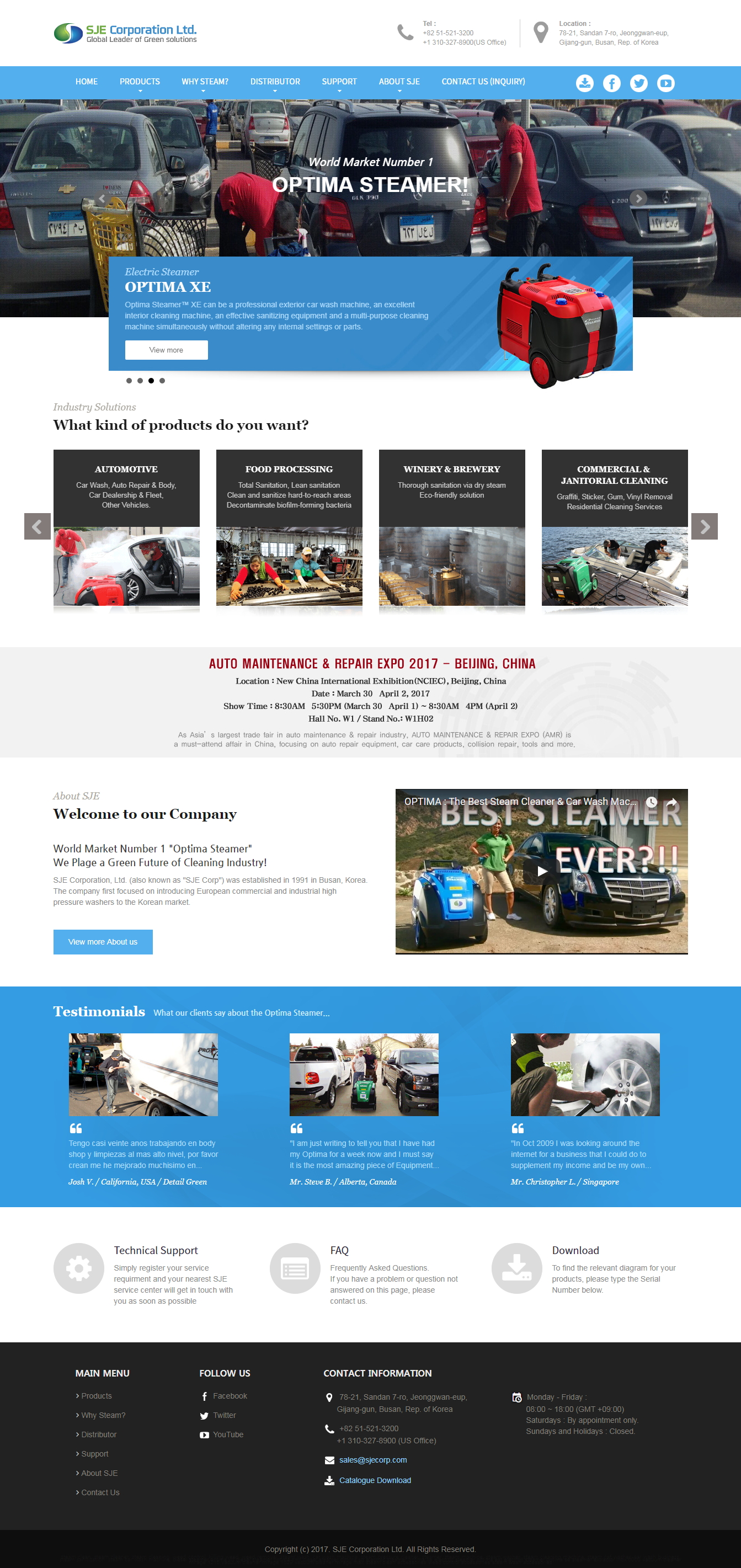

                    I will not use a water to wash the engine, i will wash it with steam machine same that in the below link.fficeffice" />
                    SJE OPTIMA STEAMER - Industrial Steam Cleaners and Steam Car Wash Machines
                    So what do you think ?

                        But what do you think about it?becouse i already purchased it and i was plannig to use it for washing the car's, beside the detailing option.
                        can it defect the proticion or the paint?
