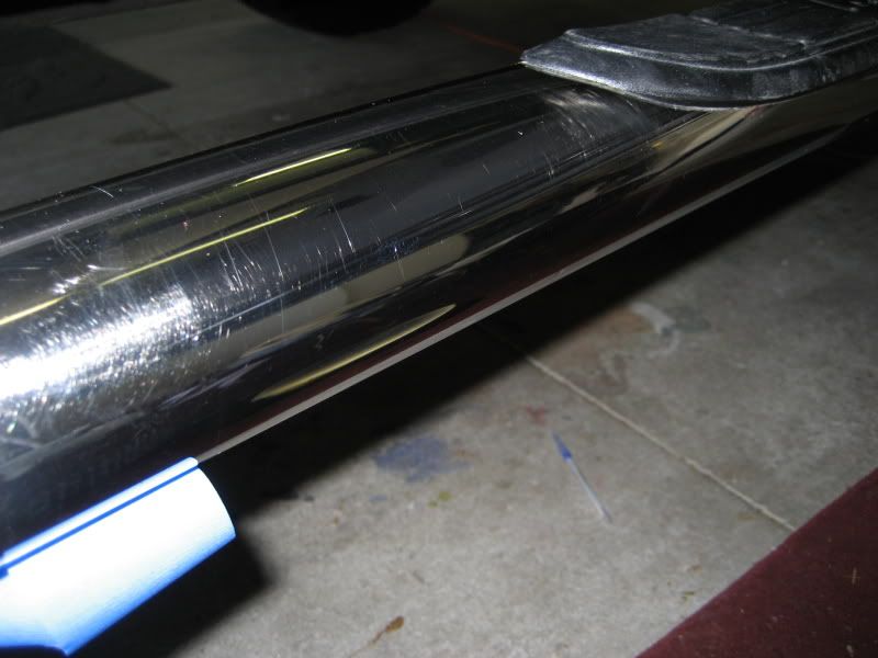

              I never have used the bonnets to remove wax, I just prefer by hand, but one thing that I have found the bonnets to have a really good use for is polishing metal. I used NXT all metal polysh on my step bars with the G110 and a bonnet. I just smeared some product on the bar, started on speed 1 to work it in without splattering since the step bar is a hard shape, and gradually worked the speed up to 5. Here are some pics:
              Remove swirls my friends.
