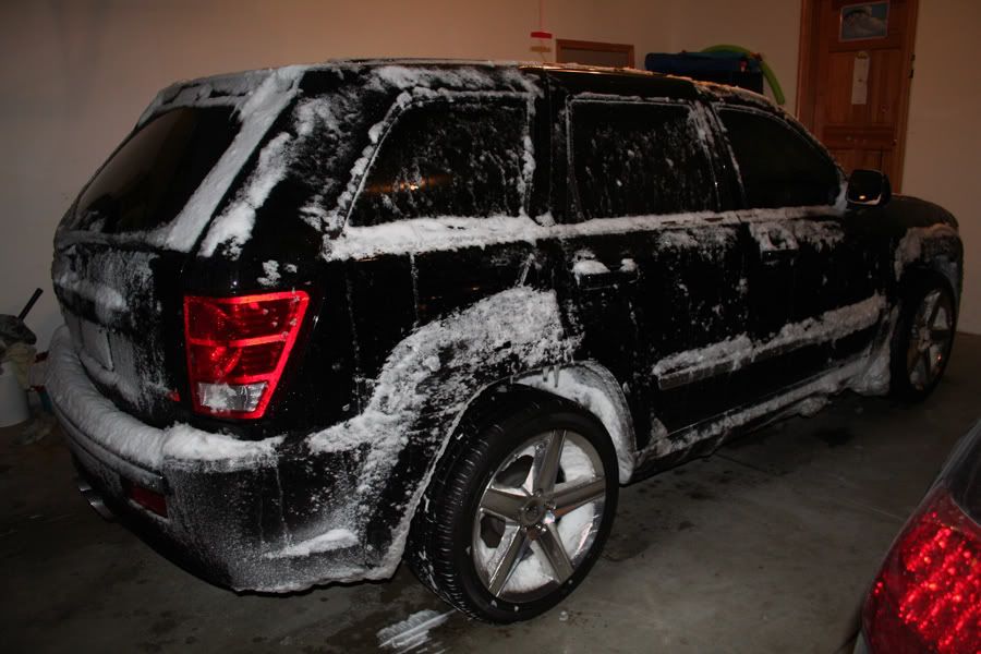

    So, I've detailed plenty, but almost always by hand, and had great results so far. This is a black 2007 Grand Cherokee SRT-8 BTW.
    Hand Results from the past....
    Well, this winter was extremely harsh on my car, so spring clean up has started, and it's going to be a long process....
