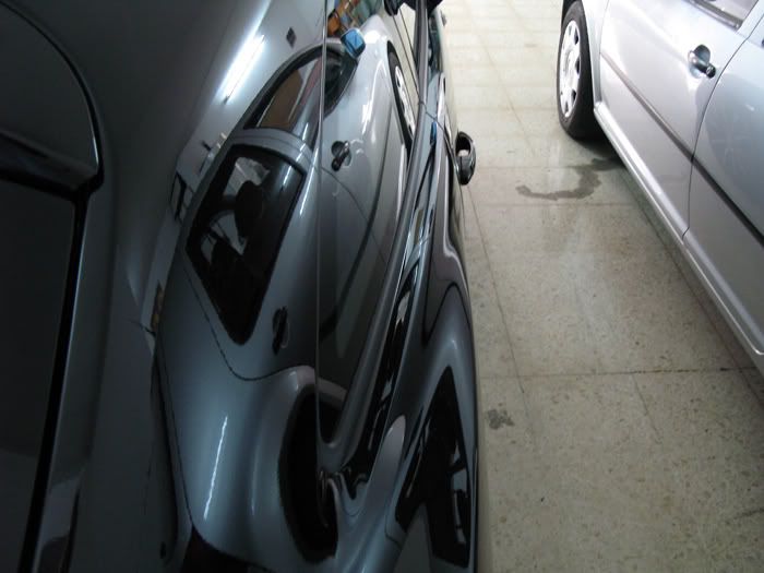

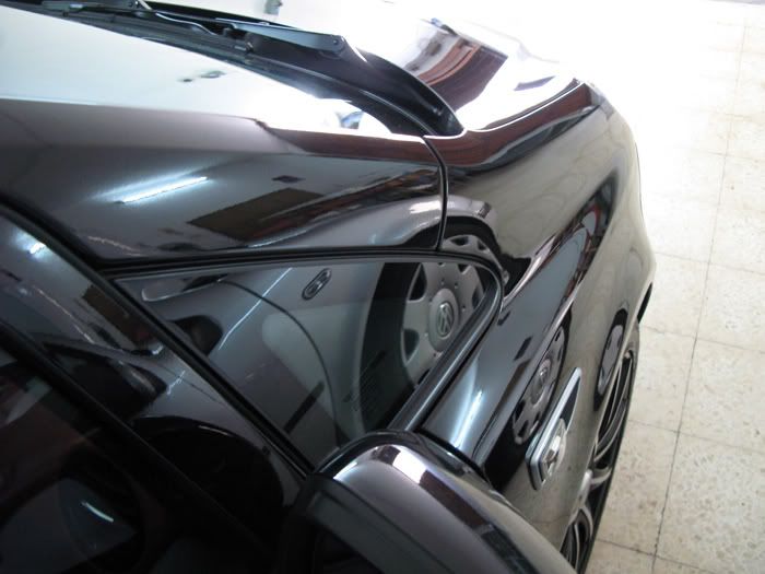

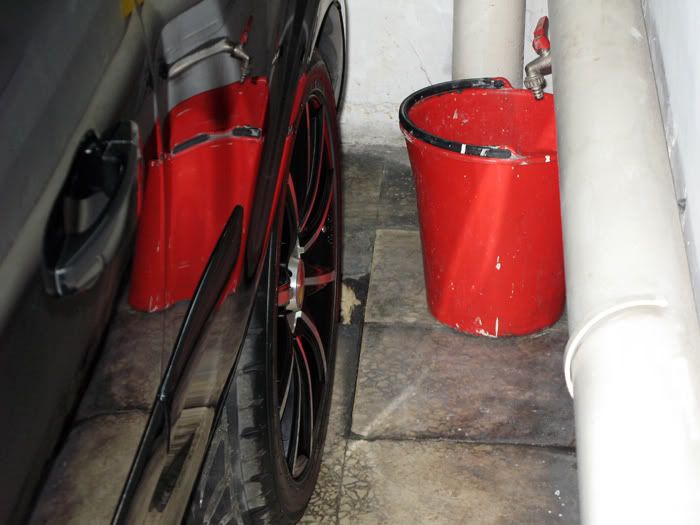

                  some pics of my success story.
                  not sure if i can mention other brands, however here you go...
                  washed with Autoglym's Bodywork Shampoo Conditioner
                  clayed using Meg's Smooth Surface Clay Kit
                  totally Scratch Xed (Meg's)
                  polished Autoglym's Ultra Deep Shine
                  waxed Meg's Cleaner Wax
                  waxed Autoglym's High Definition Wax
                  wheels dressed in Autoglym's Instant Tyre Dressing
                  Reflected is my brother's Golf...enjoy!!!
                  • #24
                    Re: hi (help pls)
                    Looks great!
                    Just a tip, though, avoid putting any towels or chamois that touch your paint on the ground, or surfaces that could be dirty (like that tire!). You run the risk of scratching the paint down the road when you use it again.
                    Aside from that, looks like you did a fantastic job...the black looks fantastic!
                    • #25
                      Re: hi (help pls)
                      Looks great!
                      thanks! aw of course not that towel belongs to dad and his car!!!!

                        outdoor pics!
                        thanks for all your help!!!
