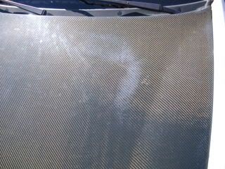

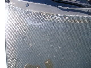

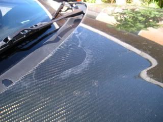

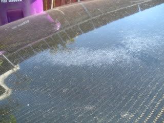

    Whats up? I'm new here, hoping to find some help. I'm not very good at detailing, which happens to put me in a position where my CF hood is getting damaged. White hazes, and oxidation started to appear after about a month since I bought it. Any suggestions would be gladly taken. I just need to know the steps and procedures i need to get my CF hood looking factory new.

    Is there CC/gelcoat failure on the 2nd and 3rd picture or it is my idea??If yes i think there is no way to save it...

      I don't think so. When I purchased it, the hood was practically new. It started to appear within a few weeks. Im thinking its because I didn't wax it? or i left it open to the sun a few times.

        From your pictures it looks like your have a clear coated carbon fiber hood and the clear layer is peeling off and suffering what's called clear coat failure at the same time.
        If this is the case, there's no way to fix either problem.

                  the hood is about 2-3 months old. I guess... there's nothing I can do about it?

                    it's most likely CC failure.

                      Usually, if a surface oxidizes, it oxidizes evenly over the entire surface exposed to the elements.
                      In this picture, the affected area is isolated and has the tale-tale signs of turning white which is an indicator of clear coat failure.
                      If that's the case, and it looks like it is, then nothing will fix the problem, at least for very long. Applying a product may darken the white parts temporarily but with exposure to sun and water the whiteness will re-appear.
                      Abrading the affected area will only be temporary as the problem is not topical but throughout the layer of clear, thus removing a little material off the surface won't fix the problem.
