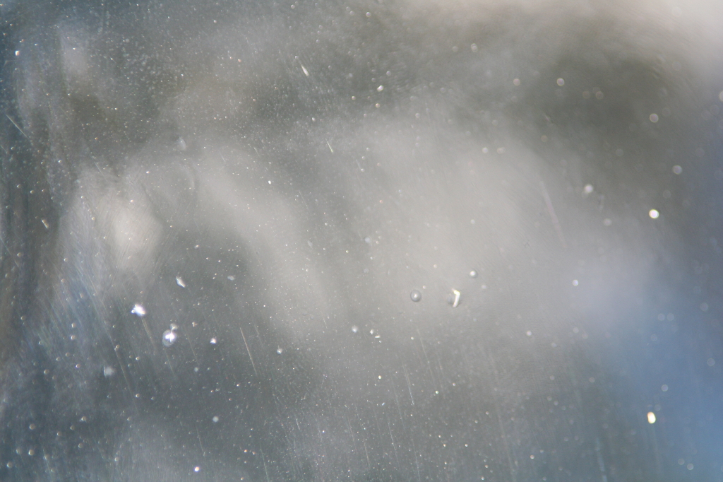

        These are a few shots of some of the issues. I'm also getting a cloudy finish when I apply the # 26.
          Re: Using a Cyclo with #9 to remove swirls
          Note for above pics:
          The pics shown are not after the application. They are just examples of some of the light "scratches" that are behind the swirls.
          The photo of the "blem" is of one on the roof. The pic with the "bumps" is on the passenger side behind the side rear window. Don't know exactly what they are, but I'ver heard horror stories of these cars leaving the factory with these types of issues.
          Thanks.

            What are you working on?
            • Brand new car?
            • Older car?
            • Has it been repainted?
            The picture of the blem doesn't look like anything I've ever seen from the assembly line, it looks more like something has landed on the paint and mottled it or possibly touch-up paint? Is it tree sap that's hardened?
            Polishing with a foam pad and a machine polisher isn't going to fix the blem.
            M26 doesn't cloud paint, there must be something else going on?
