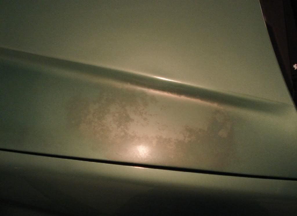

    I own a midori Honda Civic hatch and ever since I've had it, it's had this severe oxidation on the hood. Is there any way I can remove/repair this myself?
    What products will I need and methods, if it's possible? The rest of my car looks decent for being 12 years old. I plan to fix this area, if possible, this weekend. Then I plan to clay wash/clay the car, clean the car with ColorX, and then add some #7 glaze and finish with either some #26 or NXT 2.0.
    Please critique my plans and please give advice on the oxidation. Thanks!!

    There probably isn't anything to be done with this place on the hood short of repainting. I have been reading here about clearcoat failure and I believe that is what I have here. Oh well.

      If you look at the pictures in this thread,
      The Clearcoat Failure Photo Archive
      You'll see that what you have is not oxidation, but clear coat failure and the only honest fix for clear coat failure is repainting the affected panels or the entire car.

        You are correct. It certainly does look like clearcoat failure.

          Sure looks like clearcoat failure to me. Looks like a repaint is the only way to fix it.
