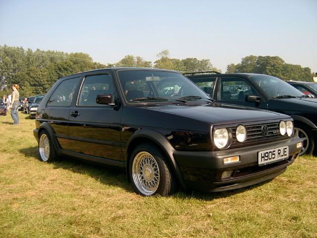

    okay ive just purchased a pc machine, my car is a 1991 vw that has original paint, that in my eyes is around 8.5/10 perfect as far as swirls are concerned
    so in the spring i want to crack out the pc and take care of these very minor swirls...considering my cars age and the fact its probably seen some action in the past, is #80 right for me
    i also find that the clear is rather soft and marks easy

        steveo3002- Nice looking car, the wheels really set off the black monochrome look. Heh heh, I like the Beavis avatar too
        I bet you'd be very happy using the #80 with the PC. Unless your paint is *VERY* soft it won't be too aggressive. It's a good learning curve product, just don't use too much and work it until it starts to turn clear/transparent (it starts out green/brown and opaque).

            accumulator thanks for your comments..its a rare factory supercharged vw, i imported it from germany
            the finish does mark very easily, i seem to remember we used #80 ? at the corvette class..but i feel my finish isnt as swirly as the car at the class
            i also have concerns that the paint is 15 years old now and i need to the least abrasive product that gets the job done. i have had a look at the ferrari thread , and mine isnt nowhere near as bad as that
            in my eyes its 8.5 out of 10 , and id like to step it up to 9.5 , so i dont need a restoration just a little tickle up
