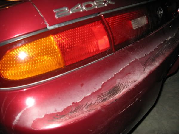

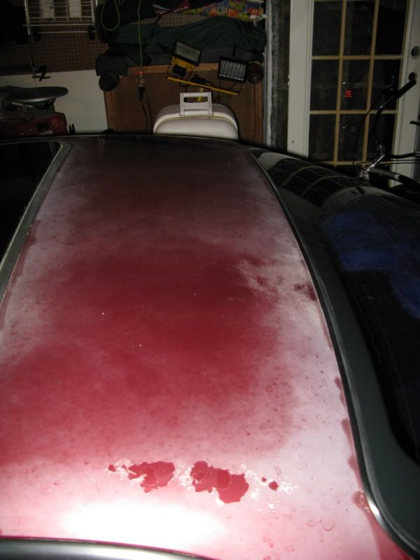

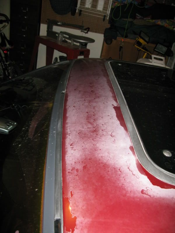

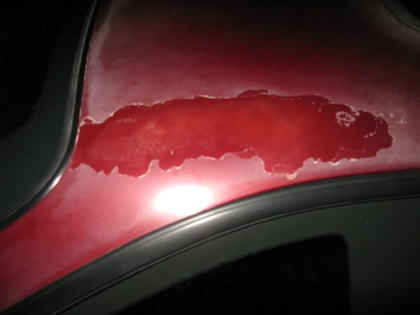

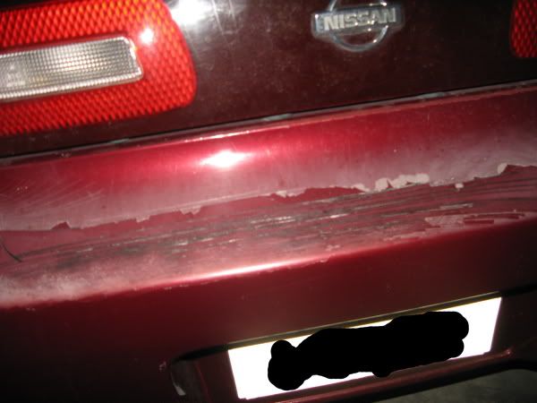

    Before I start, I want to show some pictures of my current paint finish. This has been this way since I bought the car 3 years ago. It has slowly gotten worse, and I am fed up now!
    ***WARNING: The paint finish you are about to see is obscenely damaged...***
    At this point, things can really only get better from here. My dad offered to help me get it repainted, but I have been quoted between 1,800 and 3,000 for a paint job. I totally understand that you pay for what you get and I am all about paying for quality, because that is what truly matters. But I was thinking to myself the other day: "My paint is so messed up that it only can be improved...why don't I make this into a learning experience?". So that is what I plan on doing soon, making it a learning experience. Worse case scenario, I have to have it professionally done like I was going to in the first place...

              PS--It may be more faster and more economical to replace your rear bumper cover with a used one or replacment part.
              It is very dificult to strip and prep bumper covers.
