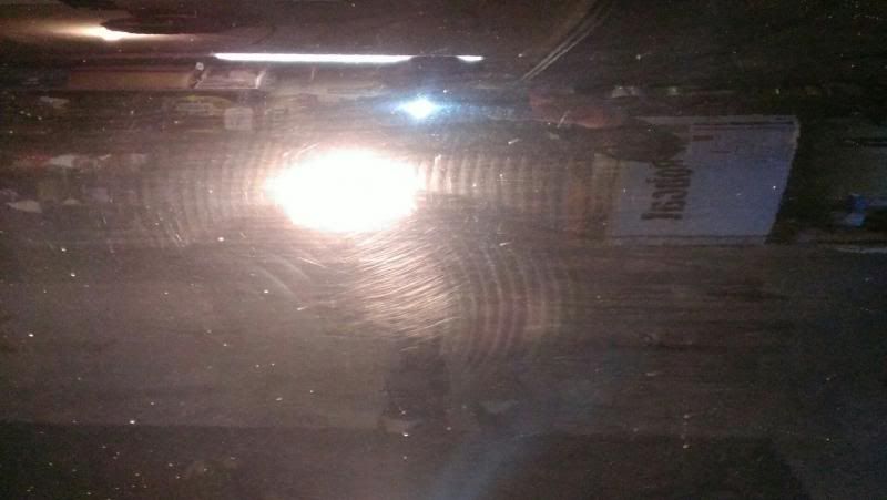

So here is what i started with,
Everything I used took care of this problem, just left some sort of other problem, which i didnt take any pictures of, being some what restrained on time, couldnt really take any process photos!

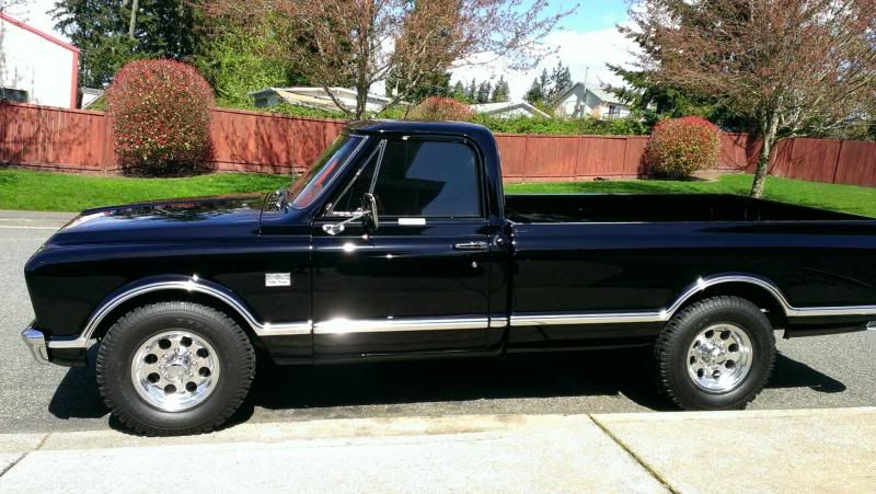

This next one is a hood shot!
This one shows a lot of the orange peel, its pretty bad when getting into the direct sunlight.

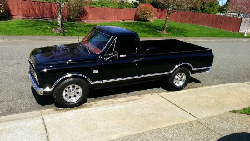

So overall i am pretty happy the way the truck has turned out, have to wax it still, going to be doing that next weekend and get it buttoned up. Also going to see what i can do to learn how to use the M205 a little better, or something, like i said not sure if i was using it wrong, but I just dont see how the 205 could leave some marring/ webbing, but the UP cleaned everything up and it has virtually no cutting ability, or an ideas ?
