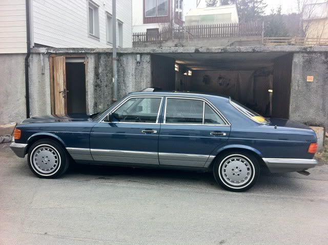

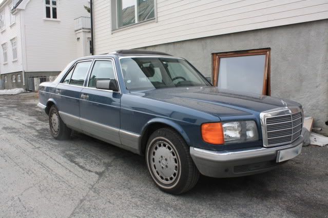

I recently bought a car from the owner of this old Merc. When I asked what he wanted for it, he said he would like a detailing job on his other car.

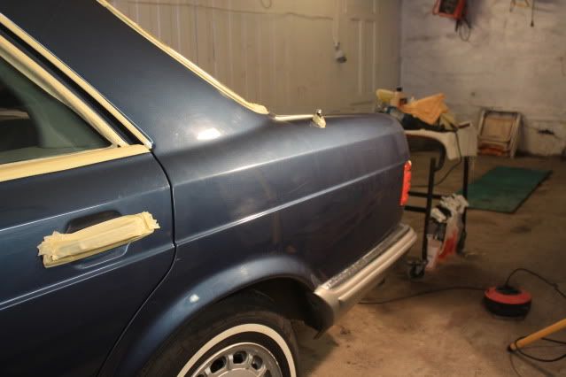

At first, it was ment to be an in/out kind of job, but when i saw the car, I decided to give it a little more, it deserves it.

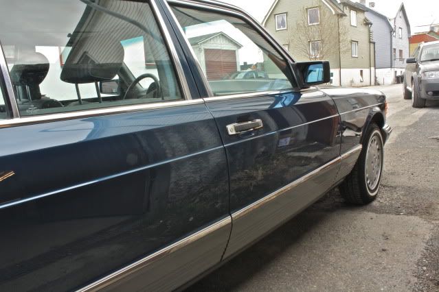

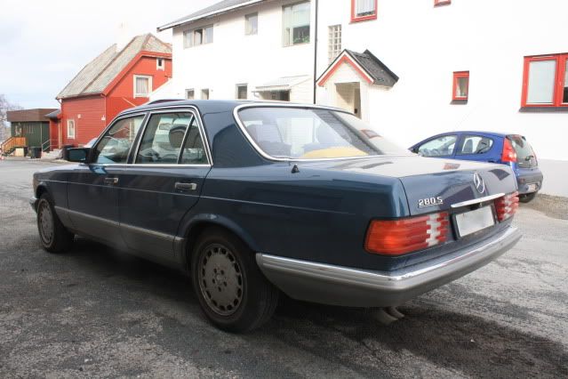

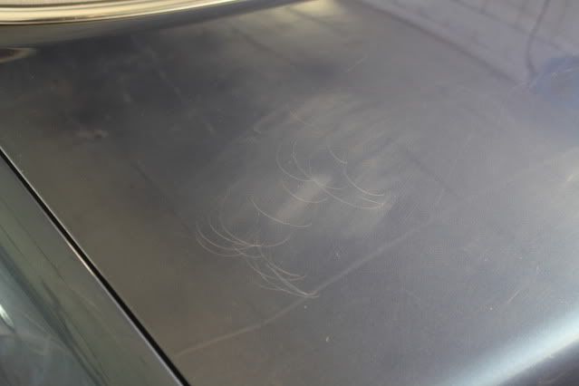

-This car has the original paint job, and 220000 kms on it.
It has been treated well, but it needed some spa treatment. I decided to go with a two-step for it.
upon delivery (washed the day before by owner)

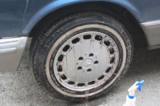

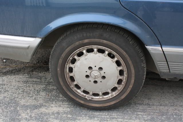

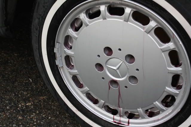

Wash process, wheels:

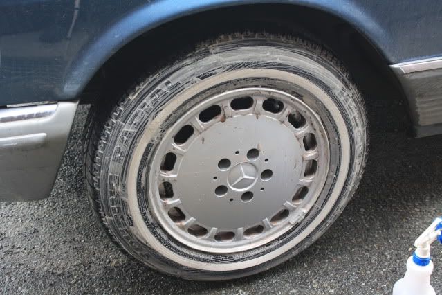

Rims cleaned with Wheel Brightener 4:1 and spritzed with WB 10:1 while brushing
Tires cleaned with APC 4:1 -white stripe on tire wall was still brown, so:
Tires cleaned again with #39
After cleaning, rims recieved Carpro IronX for iron cut

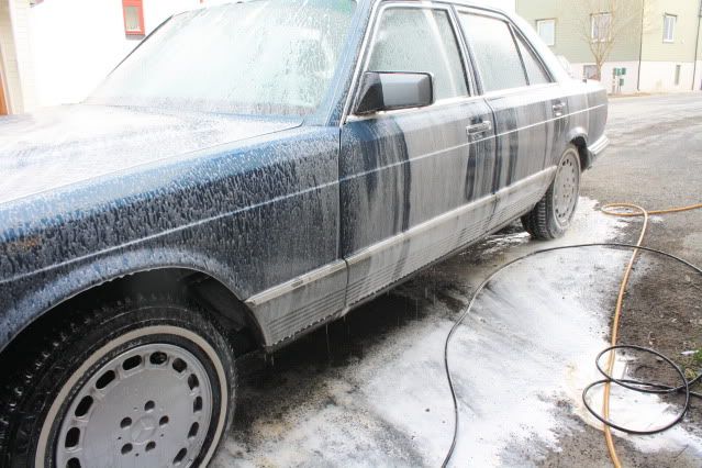

Wash process, body:
Mac 124 Prickbort (body solvent/degreaser)
Grille/emblems etc. cleaned with APC 10:1
Entire car foamed with Shampoo Plus via K
