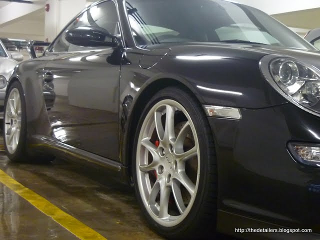

    upon arrival

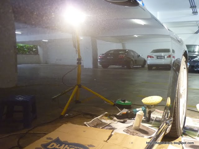

    the beast look ok from a distance but...upon closer & under 300 watt Halogen light....unveil
    Residues of dirt & grim from rain
    even some visible swirls did not manage to hide before wash
    closer look
    water stains from rain residues
    left side passenger door
    a good bath for this stallion

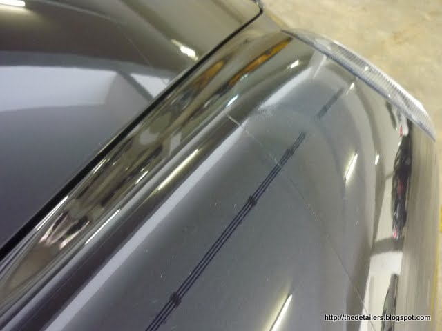

    Paint correction -
    pics taken 3 WEEKS ago- plenty of swirls & some hologramming existed....sign of
    under noon day sun
    left quater back
    pics before - swrils from improper washing
    after trying a numerous product... it seems that Megs M105 with Lake country CCS cutting pad suits the correction..as there is lots of RIDs under the swirls...awaiting to surface when the swirls is eliminating
    & Master Seech...came behind me with Optimum Polish with Megs polishing pad
    & we both finishes it with Optimum Finish with LC CCs blue finishing pad
    Protected with Opti seal by Seech
    Optimum Car wax-ed by me
    utimate shine at last, my detailing adventure will be very dull without my buddy Seech...

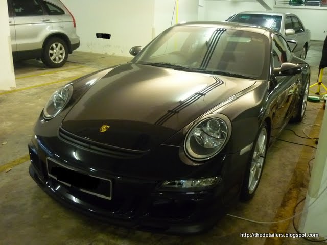

    another discovery
    special posche design stripes ?????
