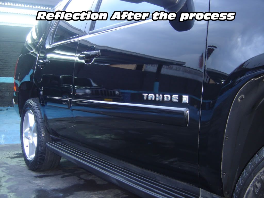

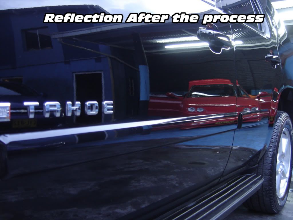

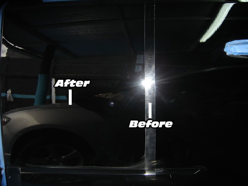

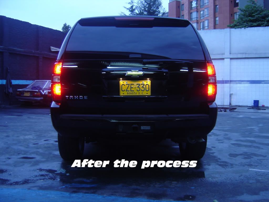

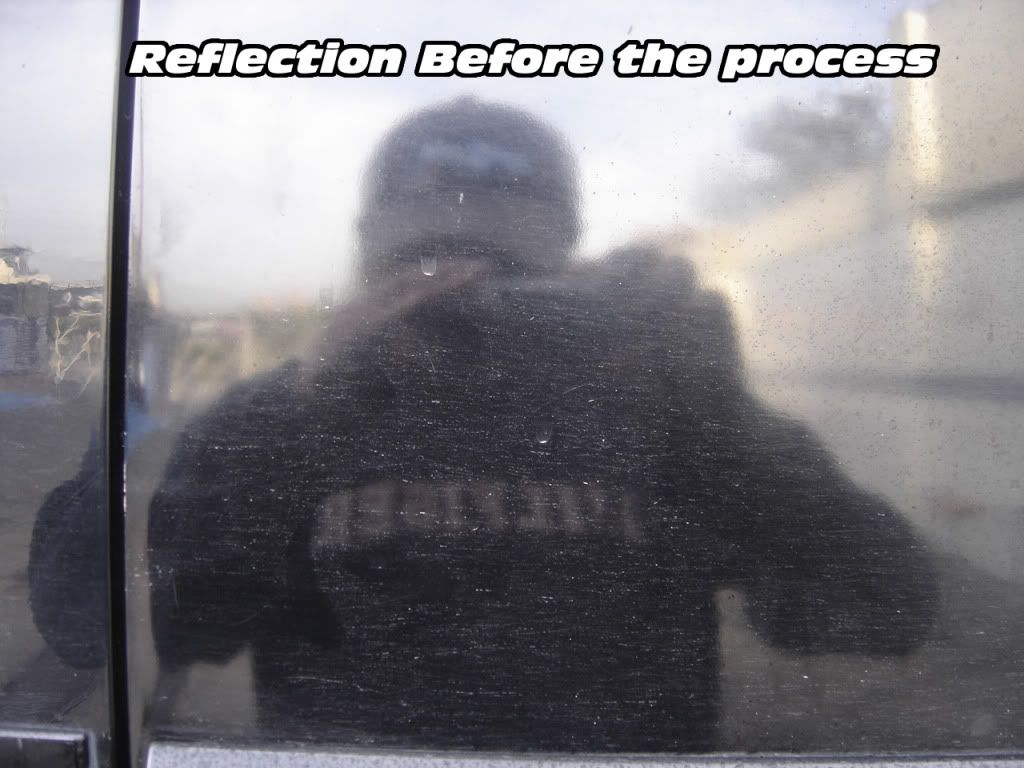

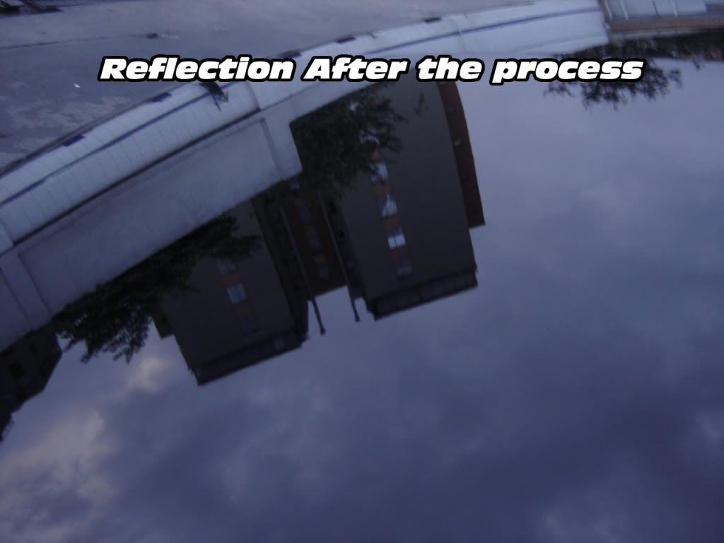

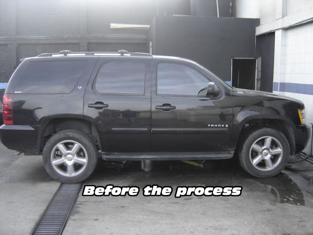

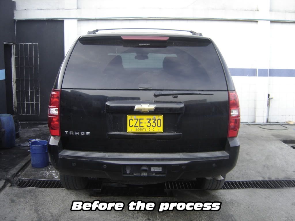

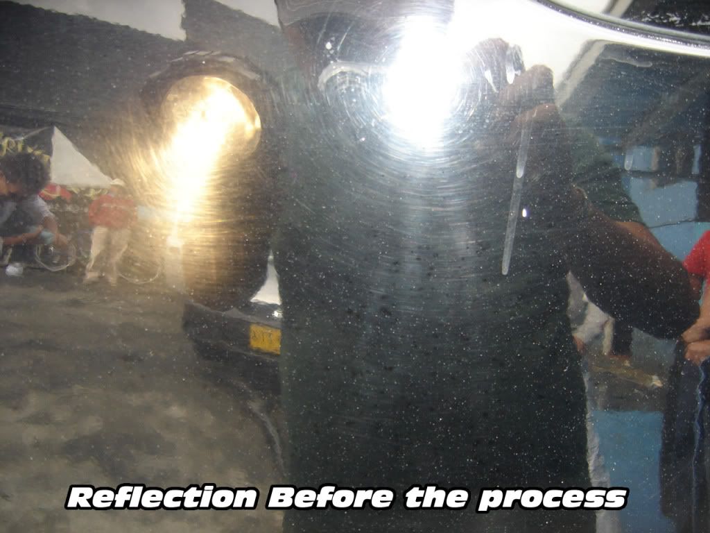

Hi everybody this is our new work... this is from Bogota Colombia south America at my car wash and detailing center .....Duster Car Clean Experience.
we just work with meguiar´s products
soooo start!!!

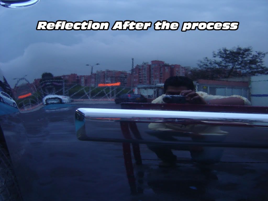

Body process
1. wash with meguiar´s gold class car wash
2. detailing clay (red one)
3. 105 ultra cut compound with rotatory and wool pad (3 times)
4. 205 ultra finishing polish whit rotatory and soft buff 2.0 yellow one (2 times)
5. Synthetic sealant with DA and soft buff 2.0 black one (one time)
6. #26 with DA and soft buff 2.0 black one (one time)
Thanks everyone who see my work!!!
This is a Colombian process powered by meguiar´s
Please tell me what do you think about my work !!!
See you in another detailing time!!!
