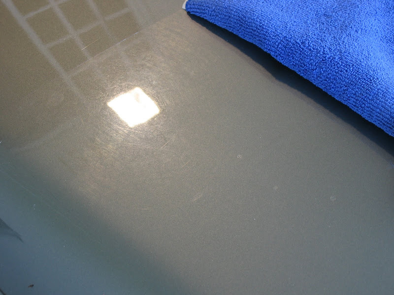

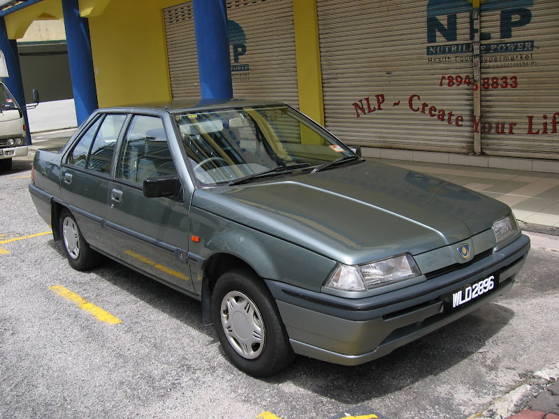

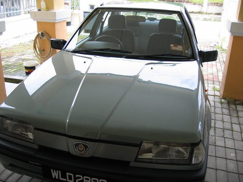

    Pic before
    unknown stains
    What did i do?
    Quick rinse off
    2 bucket wash + APC (to get rid any current waxes)

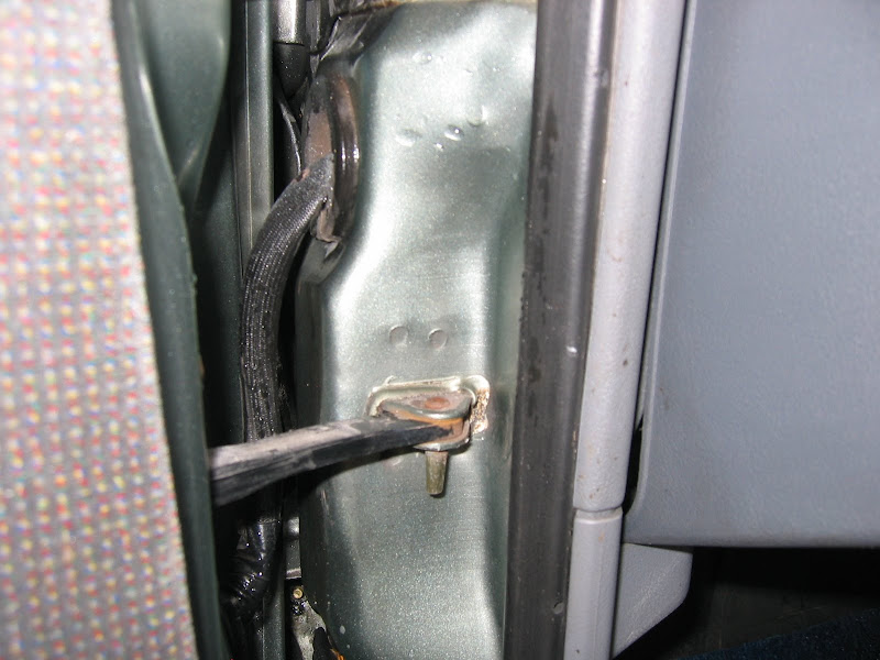

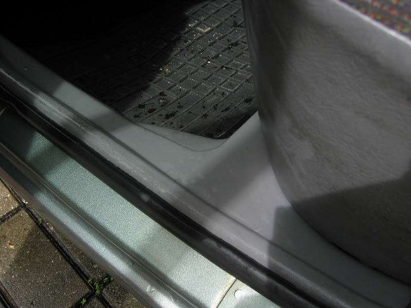

    Side door trim wash by APC & brushes
    Interior wipe down & gold class interior
    M105 with double sided wool
    D151 (my champion) with single sided wool & pad
    NXT 2.0
    Wipe down with Ultimate quik detailers

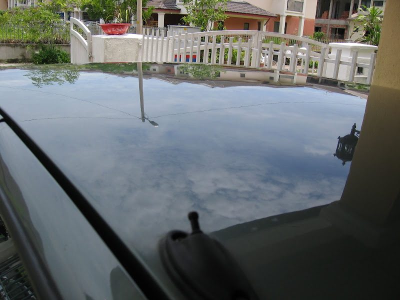

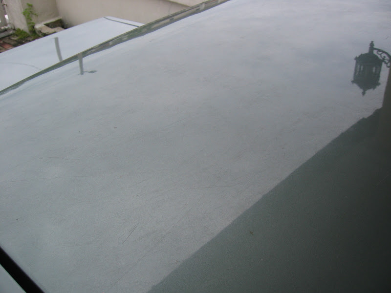

    look like a roller blade on the roof

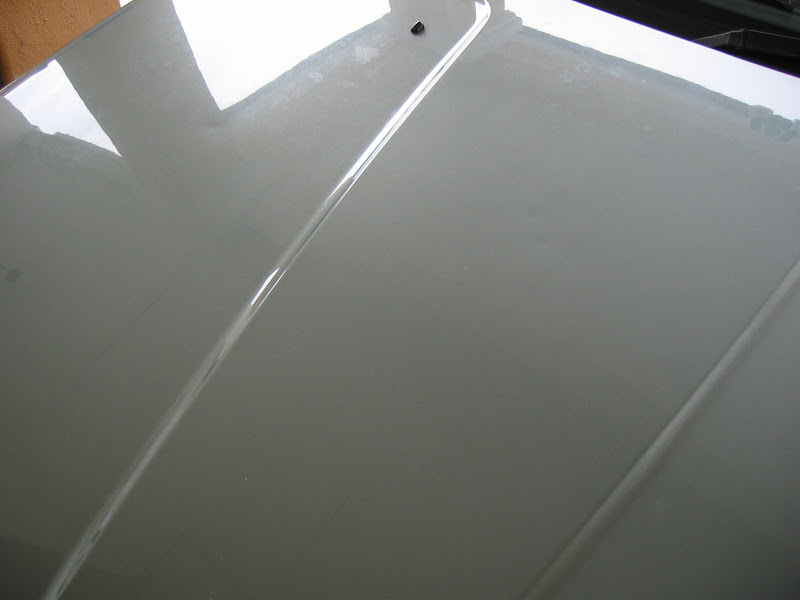

    this is new newly bought ride, 6 years ride, repainted, plenty of swirls on the roof & scratches , water marks & whitish stains
    number 1 enemy of the state (paint)
    door

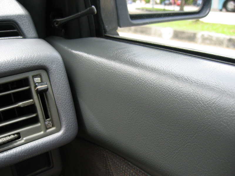

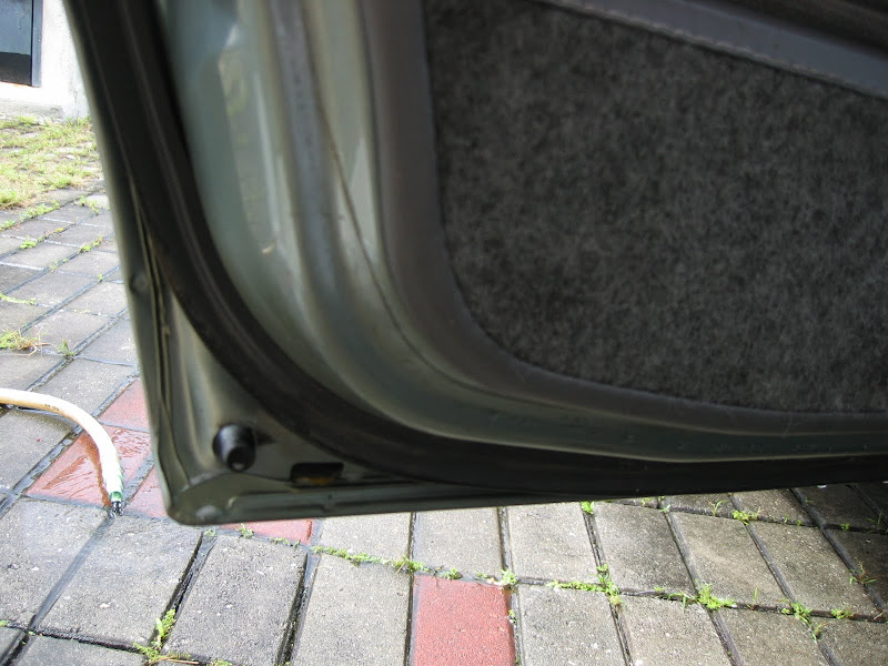

    clean interior door
    interior detailing

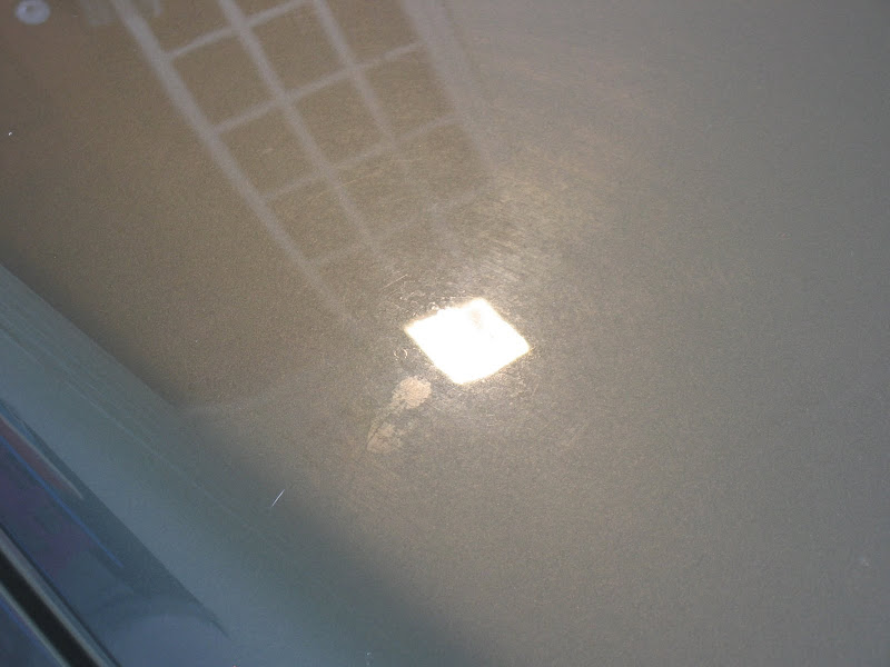

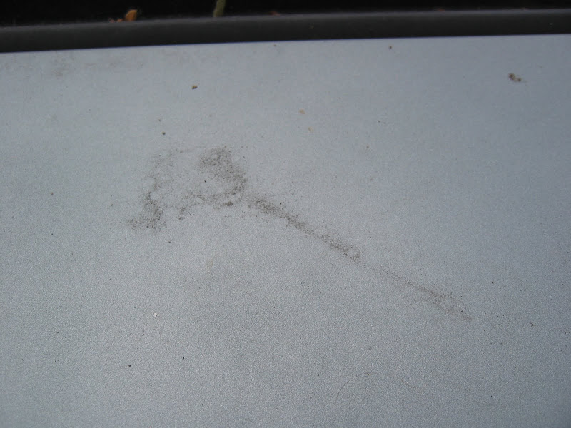

    scratches
    unknown causes, whitish stains , paint marring
    more pics
    more defects

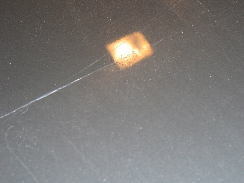

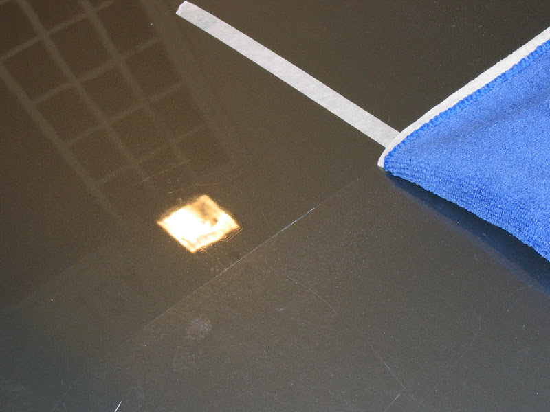

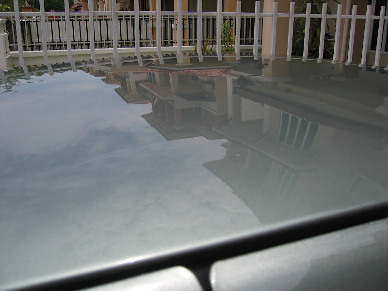

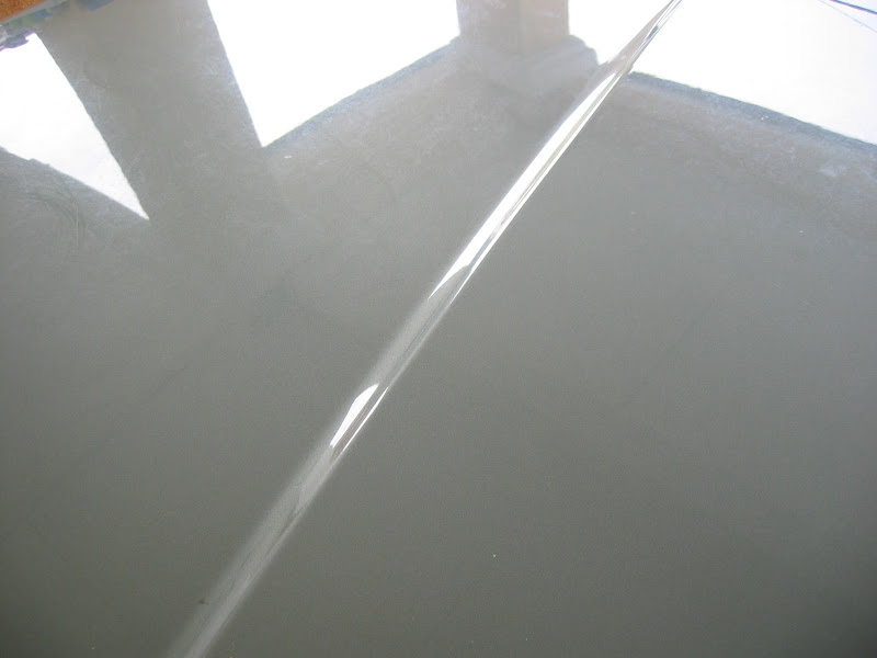

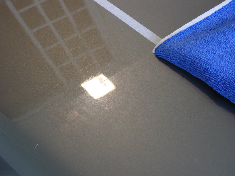

    Real work began (M105 with double sided wool)

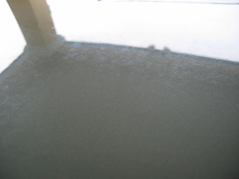

    more unknown substance

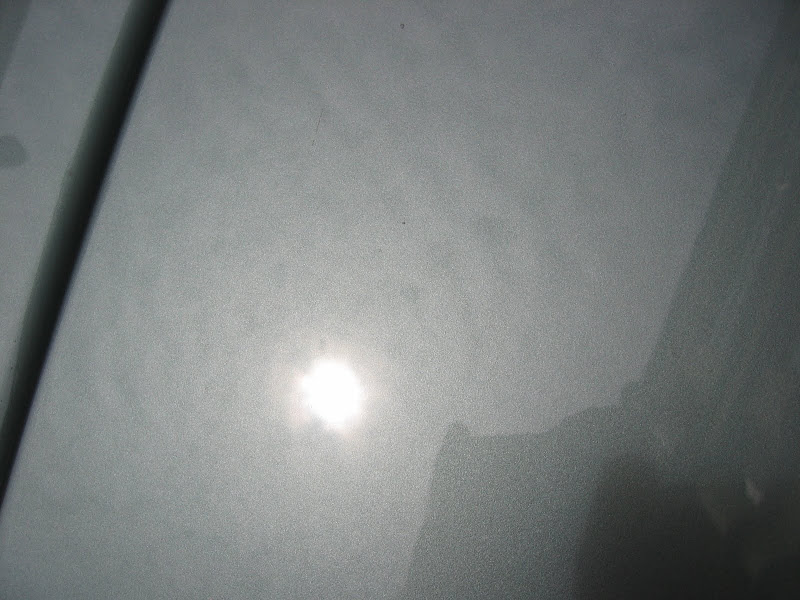

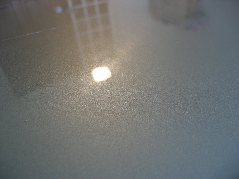

    Before
    during

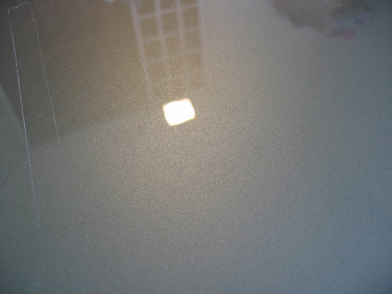

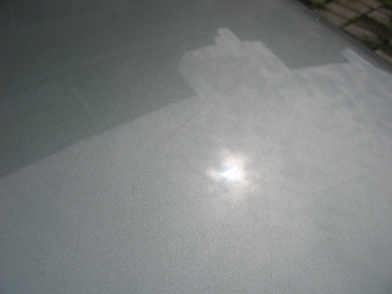

    after 50/50
    undone sites
    another 50/50
    done

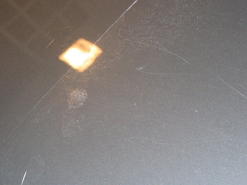

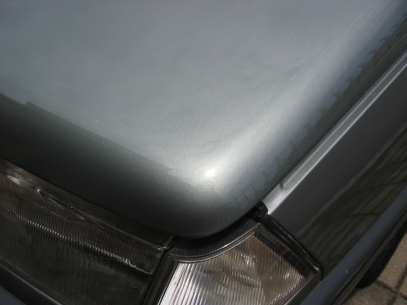

    look at the paint defects (like fungus)
    more

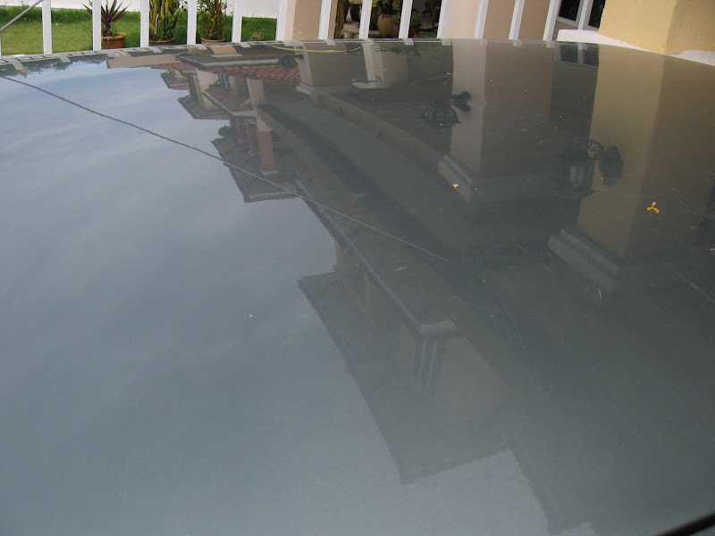

    after
    before
    after

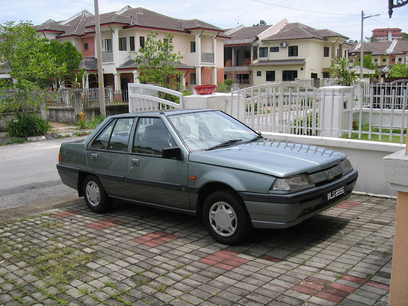

    indisputable....new

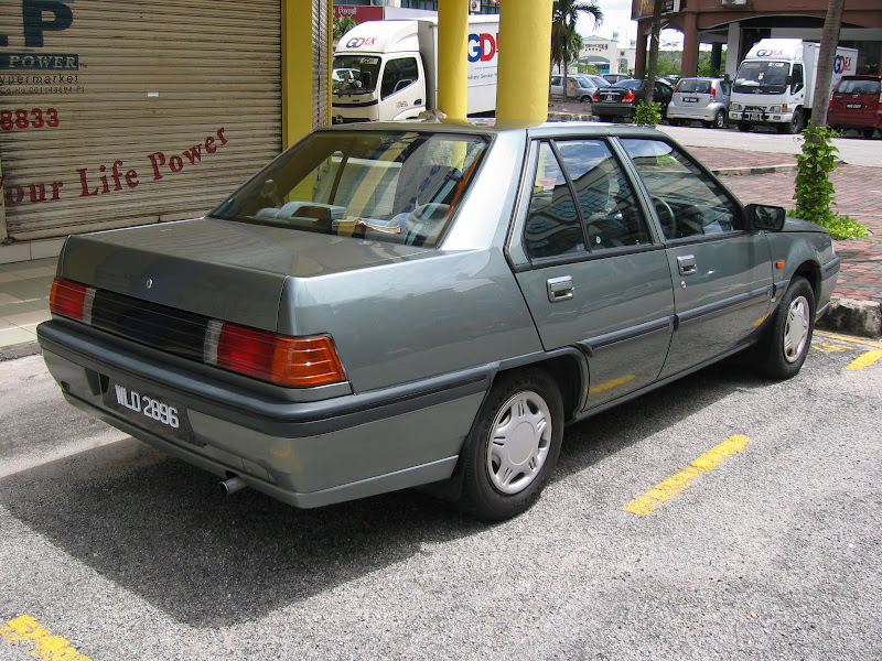

    Pics, just before the Tyre hit the road again
    waiting
    wow

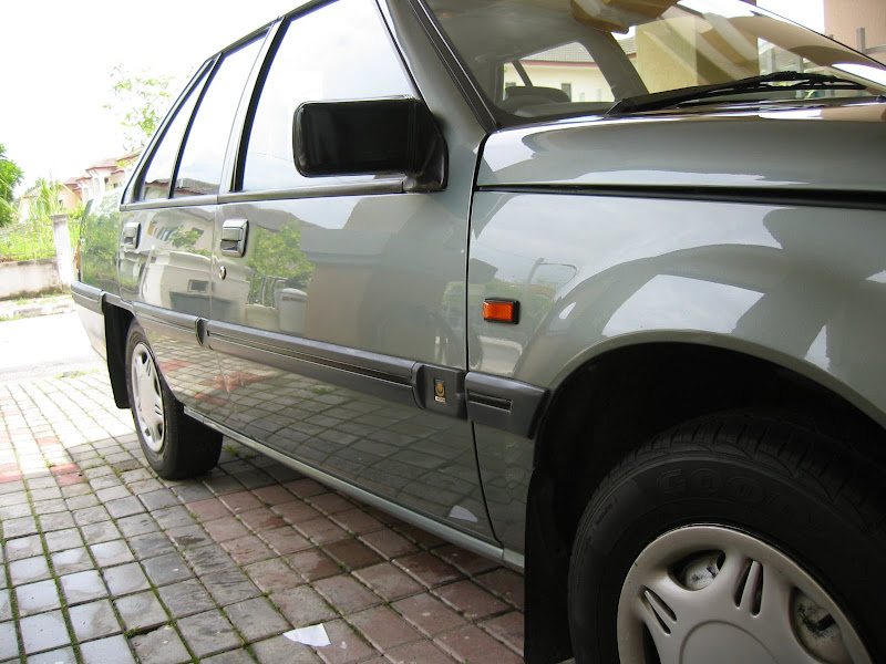

    beautifully yours again
    before it was all scratches
    now it is like driving a new ride without paying for a new installment

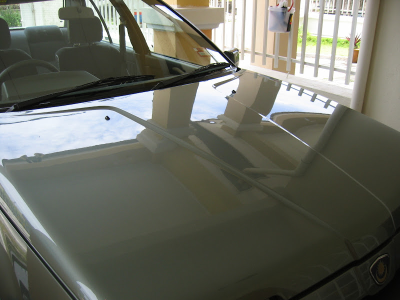

    i like the reflections

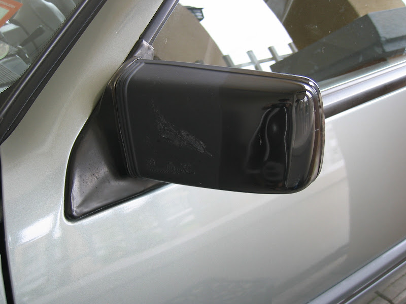

                  What did you use on the plastic? Came out really good.
                              Thanks Graci
                              Mamamia...i like it too.....its kinda secret...i dun think i would like ...but for u i would certainly does.......
                              My magic portion is:-
                              is.....
                              Is.........
                              is..................
                              is ......................... M
                              is barry ........D 151 PRC...it is also safe to use it on the head lamp...the side mirror cover is powderish & i decided to give it a rub.......with my single sided wool (be careful, very sharp) it came out a genie
