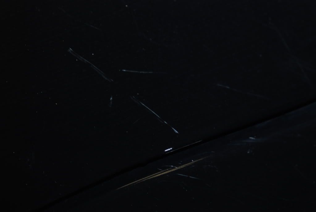

    We'll I have recently gotten back into detailing. I did it for a living during college, and high school. Try to keep the trucks clean, but with limited tools not much I can do. Have hired a couple of hacks to work on mine and the wife's and they did nothing but install new swirl marks for me, so I decided that I would do it myself. So I bought myself a PC and was dying to use it and the only thing I had available at the time was some Swirlx. So I gave it a shot on the wife's truck. Here is the results
    Before
    Here's a 50/50 shot
    and the grand Finally.
    Some Reflection Shots
    And this is by far my favorite reflection shot
    This a reflection of my truck in the paint on the wifes truck
    I have to say I am very impressed with the Mequiar's products. I had always discounted them as consumer products, did not know they even did a professional line until I found this forum. Since this I have ordered myself some 105/205 and purchased a rotary. Also ordered a bunch more Mequiar's products in preparation for my truck. When I tackle it I will post up the pics.

          Yes first time with a PC. I was a Rotary Guy, when it was my job. Production stile shop so I figured it up one day, I have buffed out a little over 8000 vehicles in my day. So the PC was a big change for me, I was a little skeptical about it at first, but the more I worked with it the more I liked it. I was quite impressed with the results, and I know with the right product the results would have been even better. Their were a few Random Scratches that I couldn't get out, just not enough cut with the SwirlX. I am sure I probably could have with the SwirlX but I didn't want to have to do 10 passes on each panel for a few scratches here and their that I am sure as we speak the wife and kids are working hard to put back in.

                          Great job. Did you clay before using the SwirlX? I am curious if SwirlX alone removed those water spots.
                              Yes Meguiars Clay and Quick Detailer.
                              Here's the process.
                              Dawn wash - lot of old wax.
                              Meg's Clay & Quick Detailer
                              Swirl X - whole truck twice - Hood 5 times.
                              Wash - Meg's Gold Car Wash
                              Glaze
                              Carnuba Wax
                              Matte Finish for Trim
