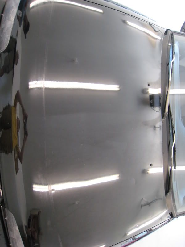

            Another thing to note about the meet.
            One of the members had brought some of his supplies. In his bag was some of the Turtle Wax Liquid Clay. Now this car had not been washed in a very long time and the paint felt like 400 grit sand paper. Prior to buffing I calyed half the hood with Meguiars Aggressive clay and he used the Liquid clay on the other side. Meguiars easily removed all above surface defects on my side and felt very smooth. The Turtle Wax side still had a rough feel but it actually removed some of the oxidized paint and the towel was black after he wiped of the excess.
            So it seems to be that the Turtle Wax Liquid Clay Bar is more of a cleaner polish than a true clay. I'll see if I can find the side by side pic of the hood. I don't think I loaded it up yet and it's on my home PC.

                Re: Open Detail training at Rasky's Auto Detailing June 21st, 2008 56K NO WAY!
                Here is a pic of the clay test. You can see how the Turlte Wax Liquid clay seemed to have a cleaning effect on the paint, pictured on the left side. Unfortunately it didn't seem to touch the above surface defects which the Meguiars clay removed with little effort.
