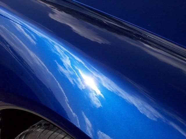

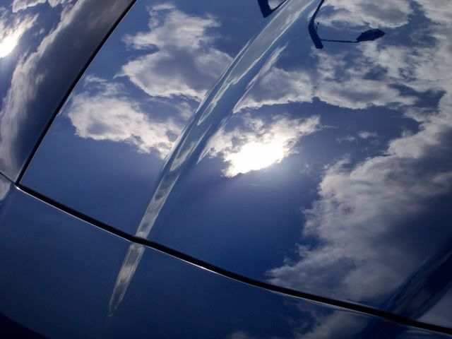

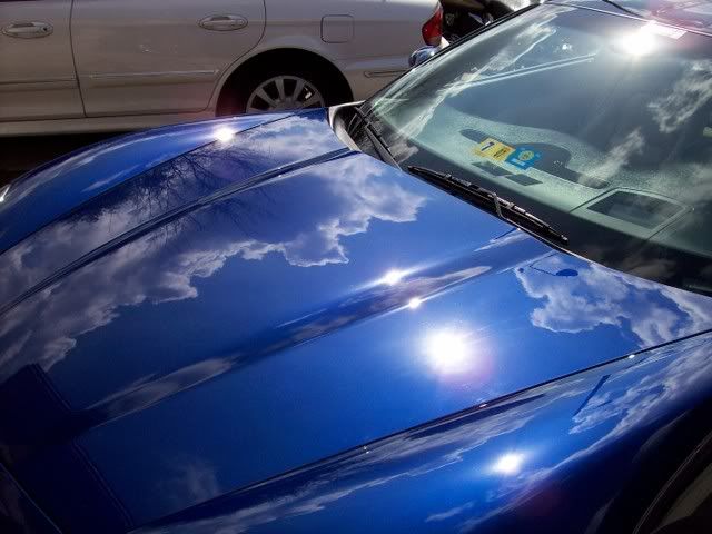

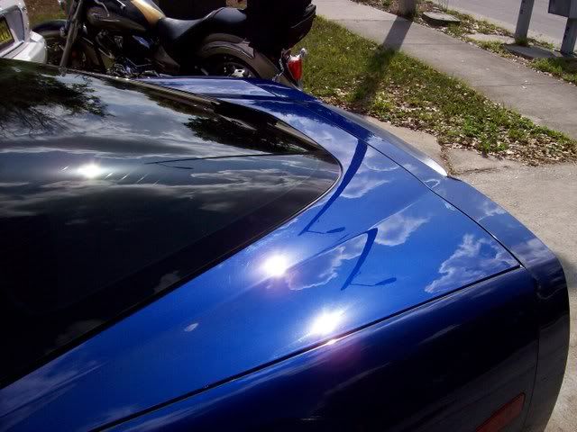

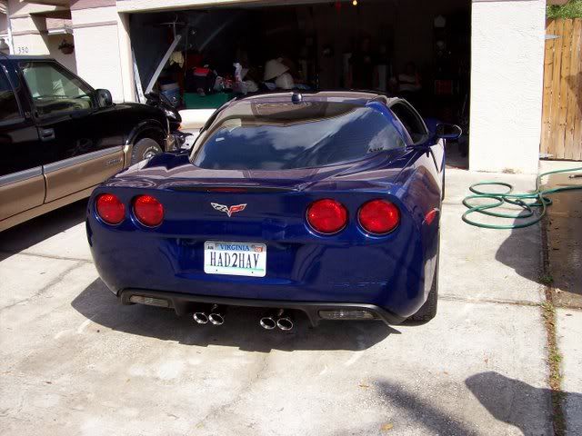

    Some pics...

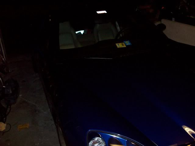

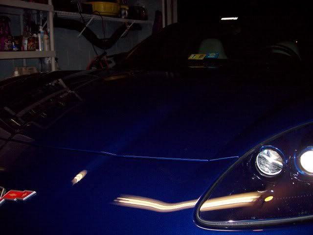

    Starting early, at 5:30 AM

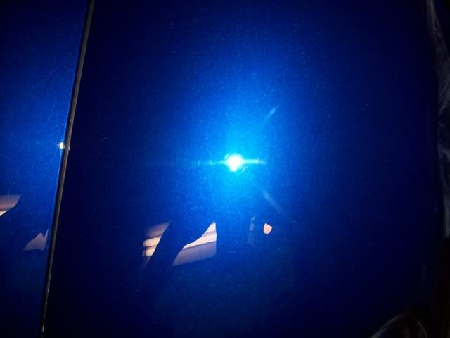

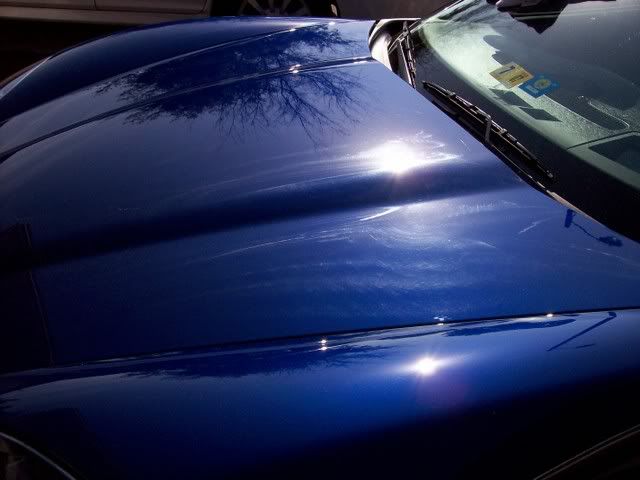

    I tried to capture some of the defects, but was having difficulty..
    I went to work. The stiff and rough Megs cutting pad does a good job of cutting out swirls on the tough C6 clear coat, but definetly leaves behind some horrible trails..

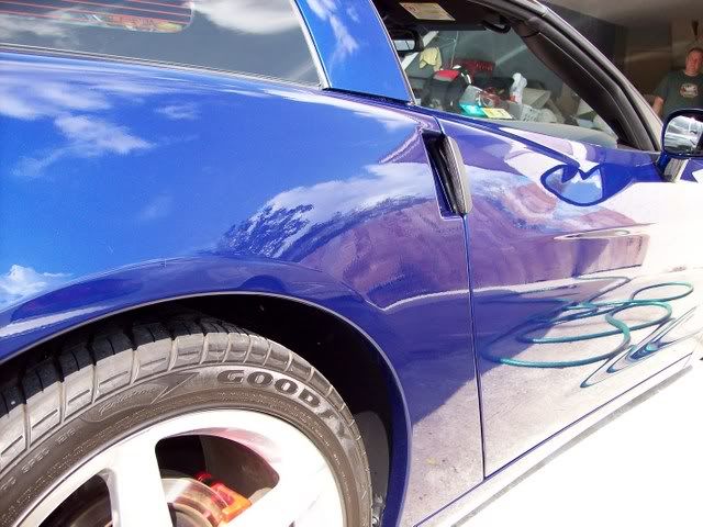

    This is after 3 passes of #84, you can see the swirls are removed but we have terrible hologramming...

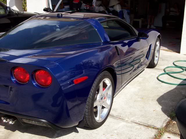

    I polished the area with 2 passes of #80 with a polishing pad and topped with #26...

    Looks like your hard work paid off. Gotta love that rock hard Corvette paint. Love the color and his plates. The second to last shot is my favorite.
