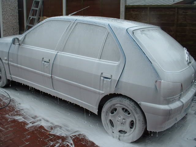

    The snow foam.........I was a bit late in getting the camera up and running

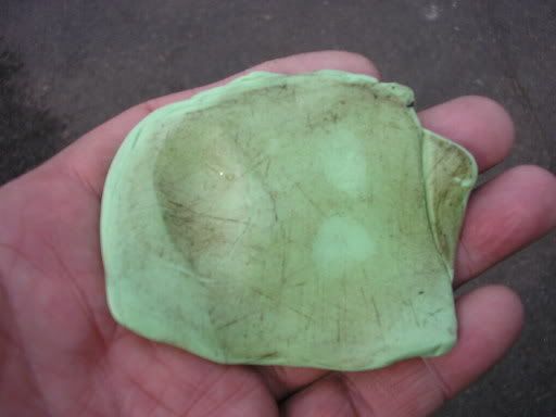

    And here is the clay there was a lot worse but I got carried away and forgot the pics

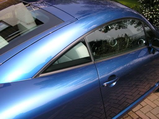

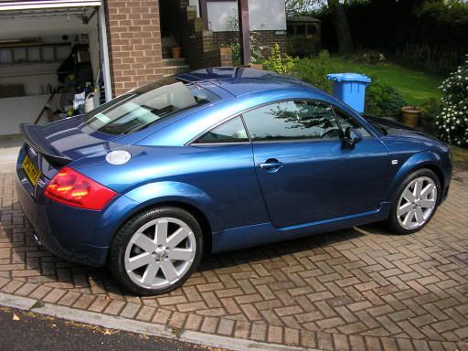

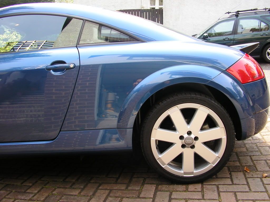

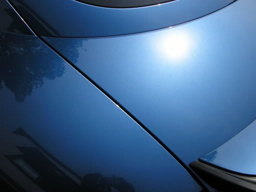

    And now for the finished article: -
    And finally.........the tree
    So apart from the leather, which I'll sort out when I get something better (it's white by the way) open to suggestions, I was happy with it...........but when my brother in law arrived he just said "that's nice" and jumped in it and off he went .........maybe it's rubbish eh
    Bryan
    PS the swirls are as they say no more.....well pleased about that I am!

      Snowfoam is something that is available here in the UK.........it's a pre wash solution which is applied via a foam gun.........you can use any car wash through the foam gun attached to the karcher pressure washer.......the car was completely white with foam but it had run off by the time I got the camera out

          This is what it looked like straight from the foam gun: -
          It basically helps loosten and remove road dirt and grime before using the mitt

                        Blr123, how long do you normally leave the foam on before you start scrubbing away w/ the mitt? This is something I must start doing.
                        2001 Vortex Blue New Beetle
                          Hi Paul,
                          I leave the foam on for a couple of minutes then rinse........then I start washing
                          Bryan
