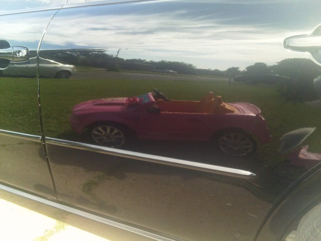

    this is my mother in laws car. Note, i did not use swirlx, only cleaner wax followed by mo7 and nxt 2.0
    Am i obsessed?? A car is the second biggest financial investment for most people, why not keep it looking better than new?
