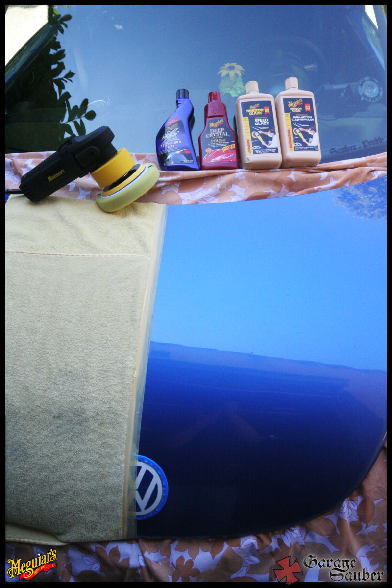

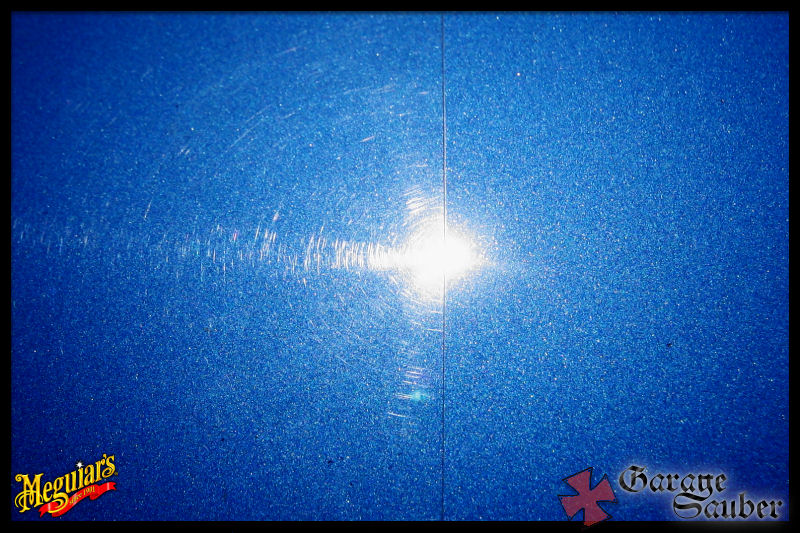

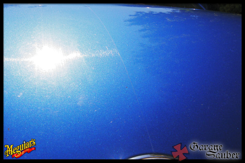

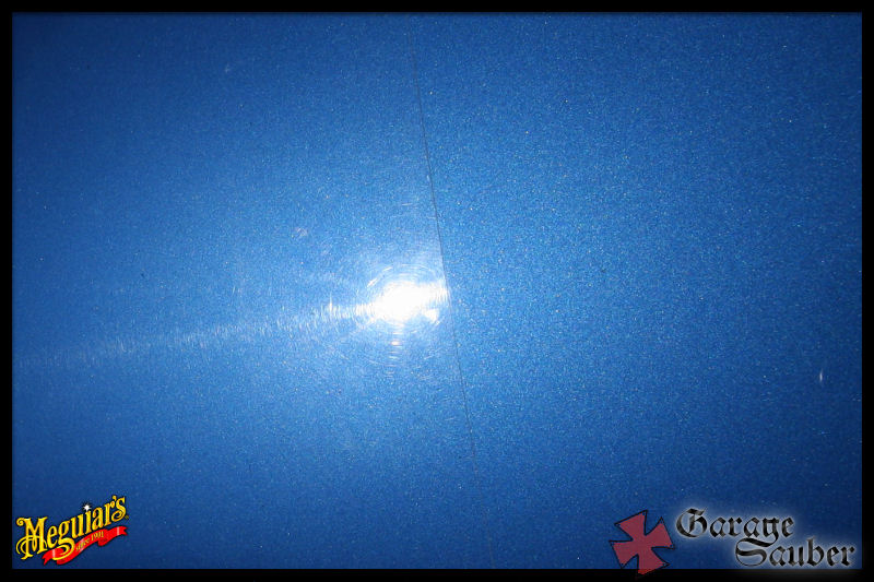

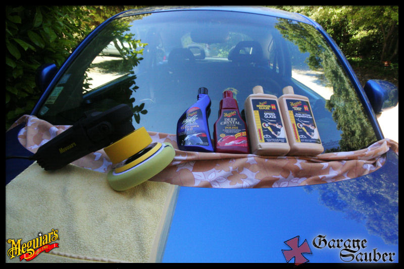

    Bonjour,
    Test Spot on NewBeetle's hood with
    QuickClay
    G220
    #83 + Pad w7006
    #80 + Pad w8006
    Etape 2 DeepCrystal
    TechWax 2.0

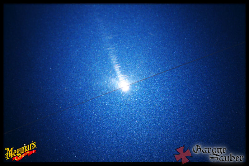

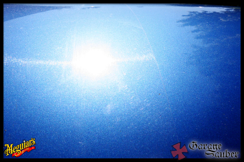

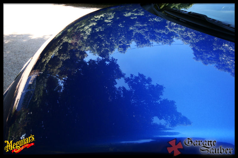

    Before
    And
    After

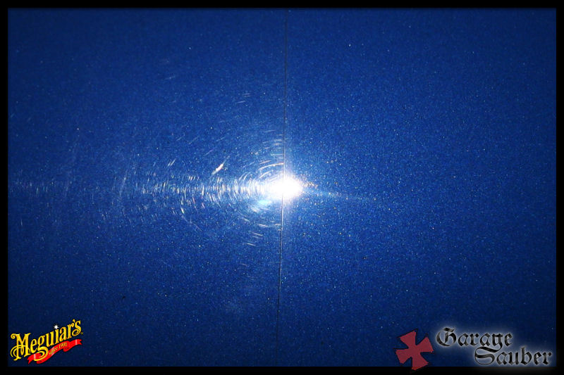

    What a improvement. Those half and half shots really show the difference.
    If I may what sppeed did you use the G220 And the W7006 pad at? I know in the states its not recomended, just curious. Thank You.
      Re: [Test Spot] VW NewBeetle
      Great color on that car. Improved 10 fold.
        great work, I always love the half and half shots
          wow what a difference! especially in the first few test shots
          2004 Mustang GT - Sonic Blue
            Awesome shots, love the side by side comparison. What a difference! Great job.

              Nice shots. Really like the reflection. How did you like the w7006 pad with m83 compared to a w8006 pad? Does it leave a haze and does it take out the scratches better?

                  Thanks, i use the speed 5. I am testing with G200 and #83 the w7006 and w8006. The W8006 it's more easy but for scratches, i prefer use w7006 for cutting. But after, i must use the #80
                  I am sorry, it's more difficult for me to speak about method in English than in French
