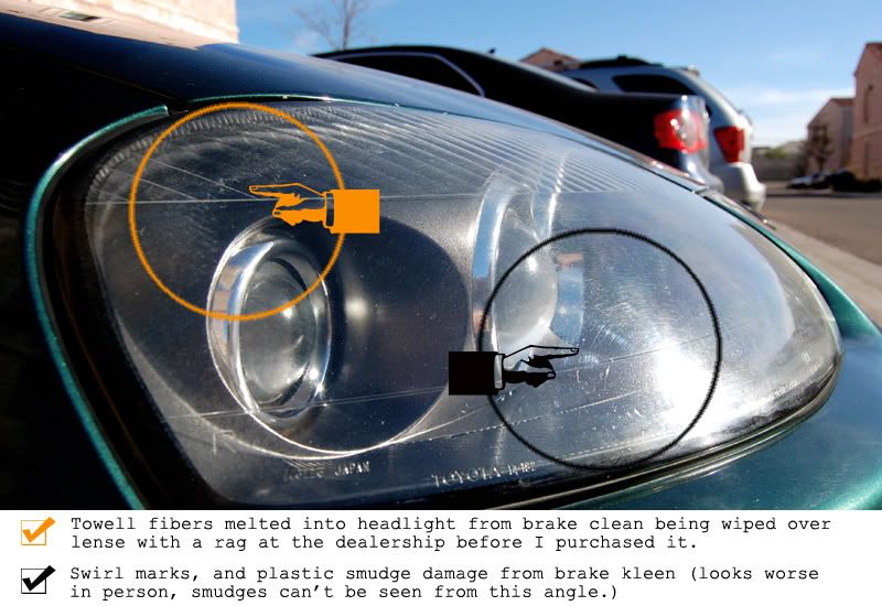

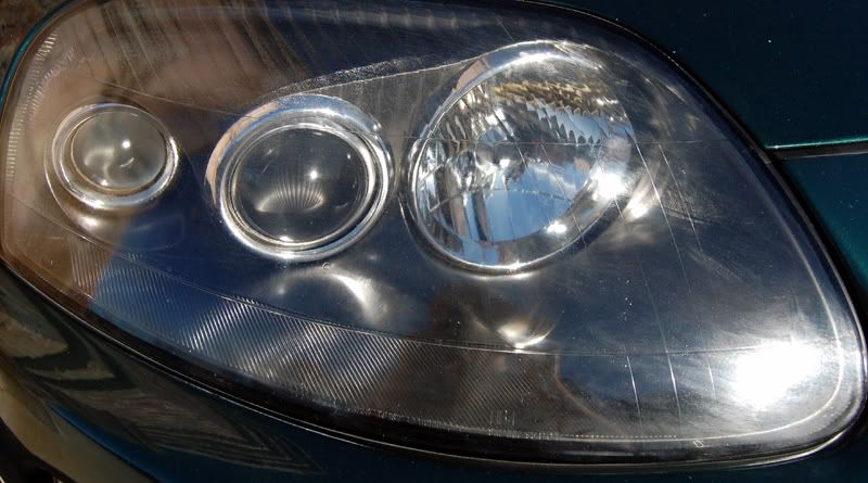

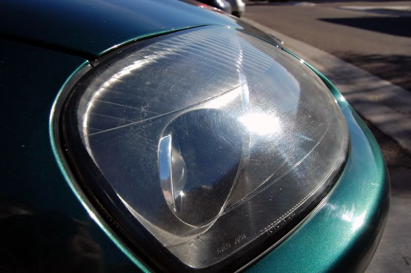

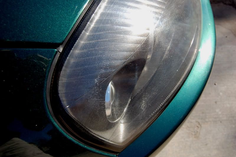

    When I purchased my supra I noticed the headlights were damaged and I knew exactly why.
    You have probably all heard the "miracle" (Stupid) lens cleaning idea to spray Brake Kleen on a rag and wipe down oxidized headlights I'm sure.
    Of course the brilliant technician who prepped my car before delivery thought he would put this to the test, and severely damaged the headlights.
    Well, there is why you DON'T EVER do that.
    There are rag fibers melted into the headlight lenses and the smudges as you can see from some of the photos are so bad - light is scattered (look at the reflection of the sun in the last picture) causing hindered night time visibility along with high blood pressure every time I wash the car and have to see this mess.
    I have spent hours and days trying to use PlastX but no luck. Does anyone know of another product I could use or a few step headlight restore kit that will make this right?
