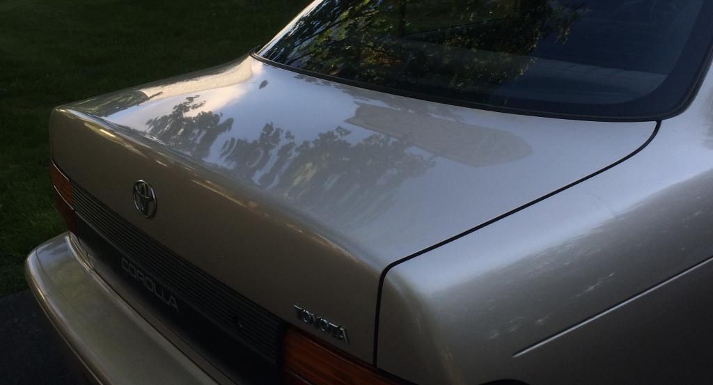

        I guess color may be the culprit - ie if it is e.g silver/light gold, swirls can be hard to see, as the sun blinds you pretty much. Night time under the parking lot light or gas station light will reveal it all...

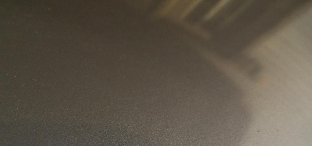

          Maybe I'm confused about what swirls are? Here are a few pictures after waxing. Maybe the paint is a little dull admittedly, I have touched up stone imperfections on the hood as well, there's not much I can do about those unfortunately.
          I didn't mean to say the finish was perfect, some of the cars on these forums are above and beyond certainly. If I can do something else to bring the finish up to those standards, please let me know. I just don't see swirls.
