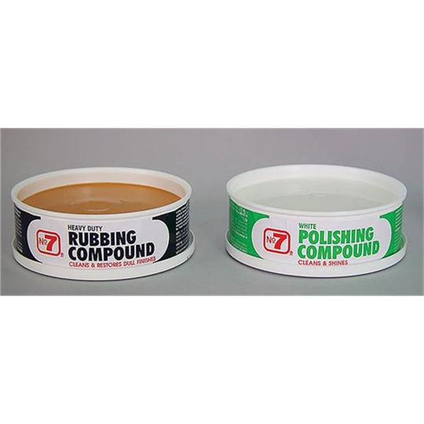

              To clarify, this is the #7 I used both to create the swirls (with powerball) and to remove them, by hand
              I got a lot of the swirls out, but some still remain.
              I probably just need to go over it once more with the right tools and technique.

                  I guess everyone thought you were using Meg's #7, which I was guilty of as well. I went back and read your original post and it said this...
                  "I used the classic #7 polishing compound and Mother's synthetic wax.
                  I used that small foam ball with drill on MAX speed."
                  It makes ALOT more sense now why you have the issues that you are having. Before I got my DA, I used the Meg's DA Power System that attached to a drill, and it worked pretty good. If you can't get a DA right now, the power system should fix your issues, if you use the correct products and technique. I would also throw that good ol No. 7 in the trash...good luck!

                        So you didn't use Meguiars M7, as we all thought. That stuff says it's a compound... using that with the Powerball and a direct drive drill on max speed is what caused the swirls / holograms.

                          Both products use the word "compound"
                          There is "polishing" and there is "rubbing"
                          So, I am pretty sure the white cream is polish.
                          • #28
                            Re: First polish/wax attempt was a disaster. Terrible results. Postmortem.
                            I used this smaller powerball.
