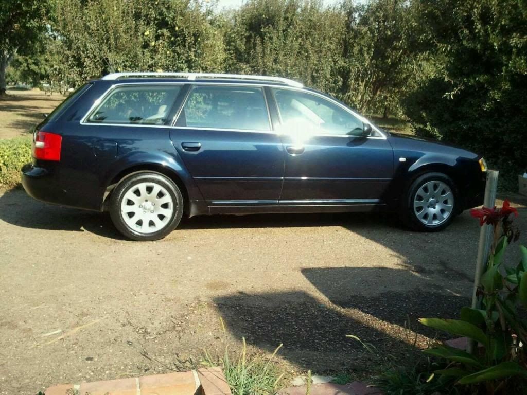

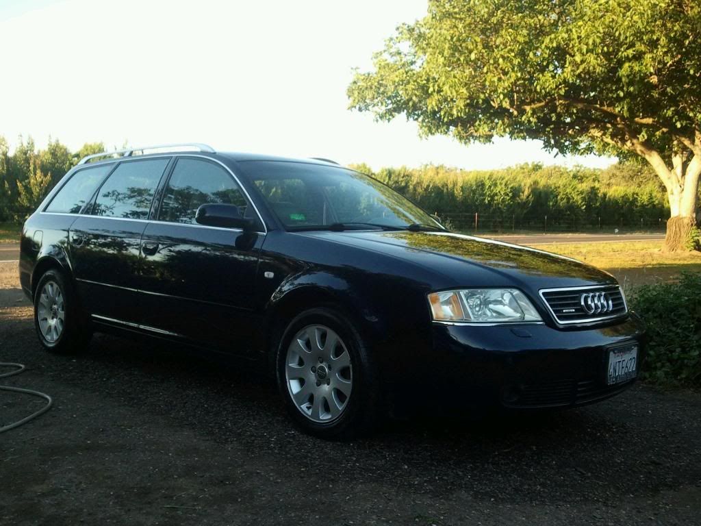

                and for your viewing pleasure
                in the shade after a good bath
                in the sun after my own 5 step process mentioned on the first post.
