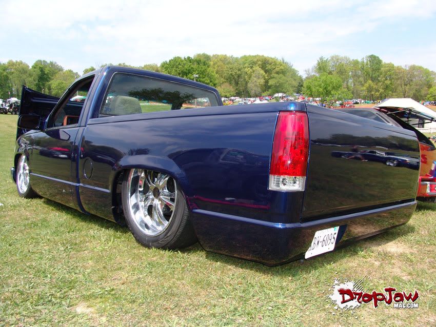

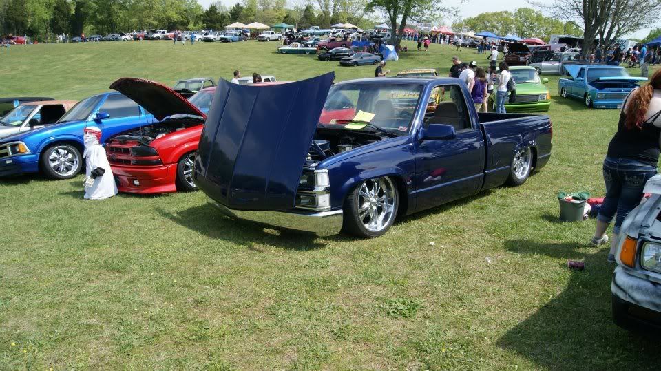

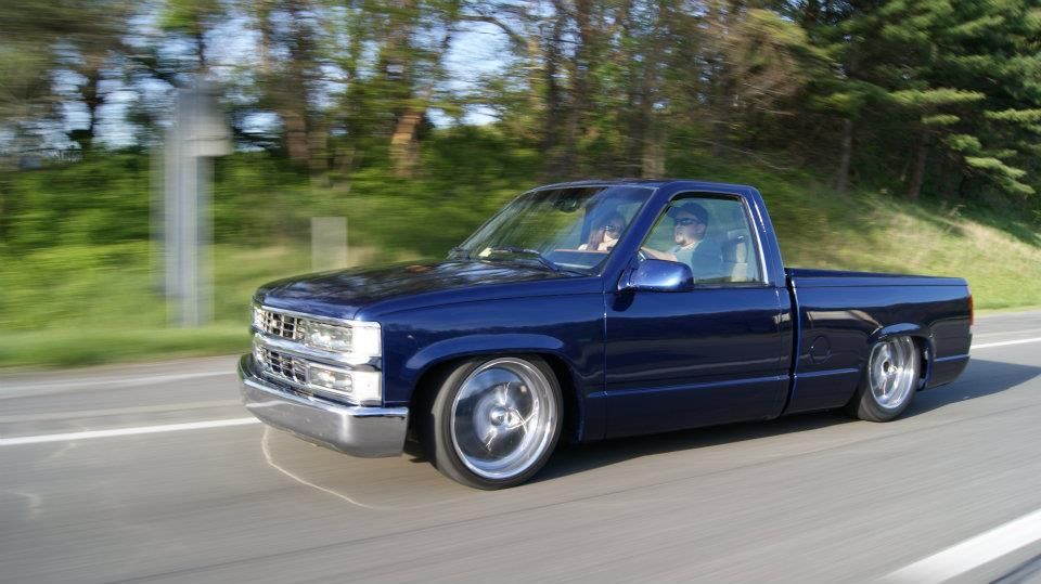

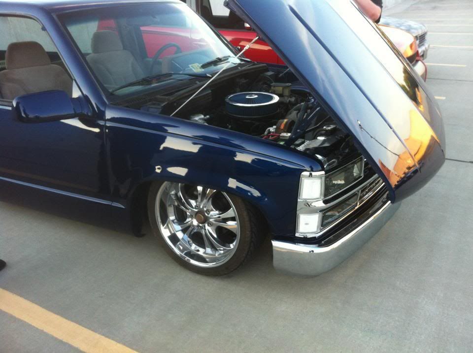

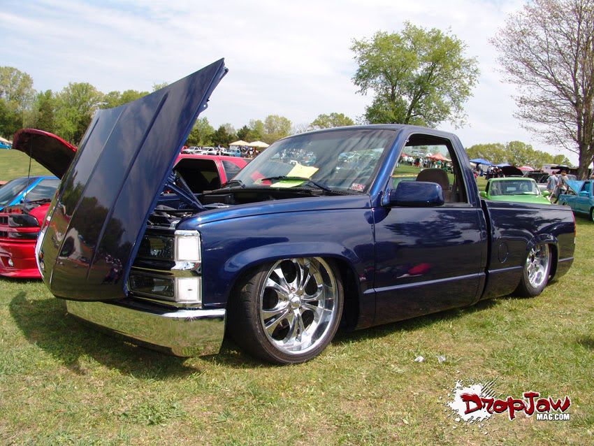

                And here are some pics. no pics of the scratches tho
                  Re: really fine scratches
                  That's a great looking truck!
