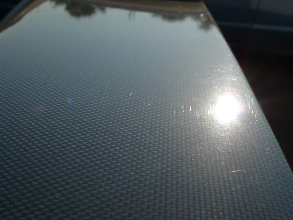

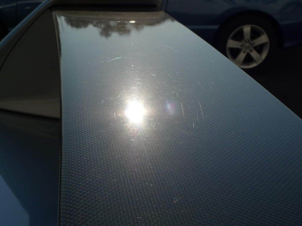

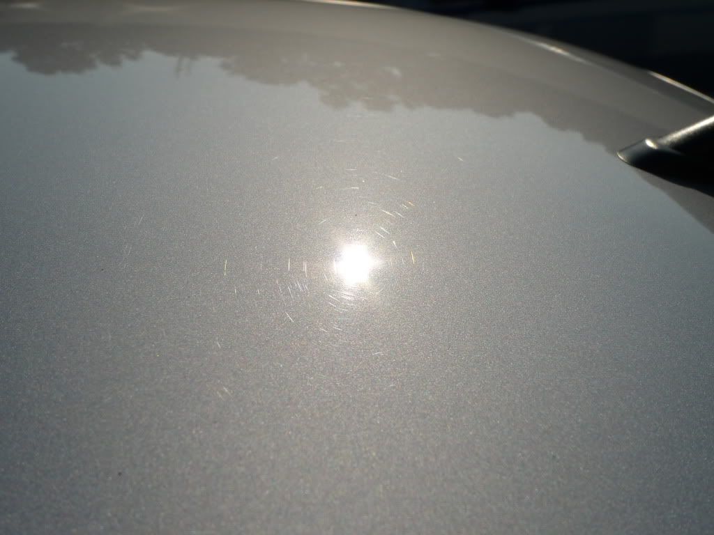

Which of my products for these spider webs?
  • Which of my products for these spider webs?
    At my disposal in the Edge 2000 pads for my PC 7424...
    Red (not listed, but even finer than White)
    White
    Blue
    Green
    Yellow
    M105 or 205
    Which pad and product combo shoul dI try first? (least aggress would be Red pad w/ 205, but I kinda want to dedicate the Red pad to just applying sealant)
    My 2006 Mitsubishi Lancer Evolution:
    Roof...
    Rear Carbon Fiber Spoiler:

    Sounds like blue and #205 is the starting point in general to do a test spot with.
      Re: Which of my products for these spider webs?
      Agreed. The swirls look fairly light.
        From the looks of things, start with the blue and M205 and move up to the green and M205 if need be. The swirls look very, very light and we would think M105 would be total overkill for them.
        M205 will let you buff all day long (just about) and since it's not a diminishing abrasive it won't break down on you and stop cutting. At the same time it has a great ability to really refine and clarify a finish, adding great depth and gloss to any color. Take your time with it and it should serve you quite well.
          Thanks for the consensus vote everyone. Any special care to be taken with that carbon fiber wing and it's edges? I have 6in pads. Hope to make a go of it some time this week!
