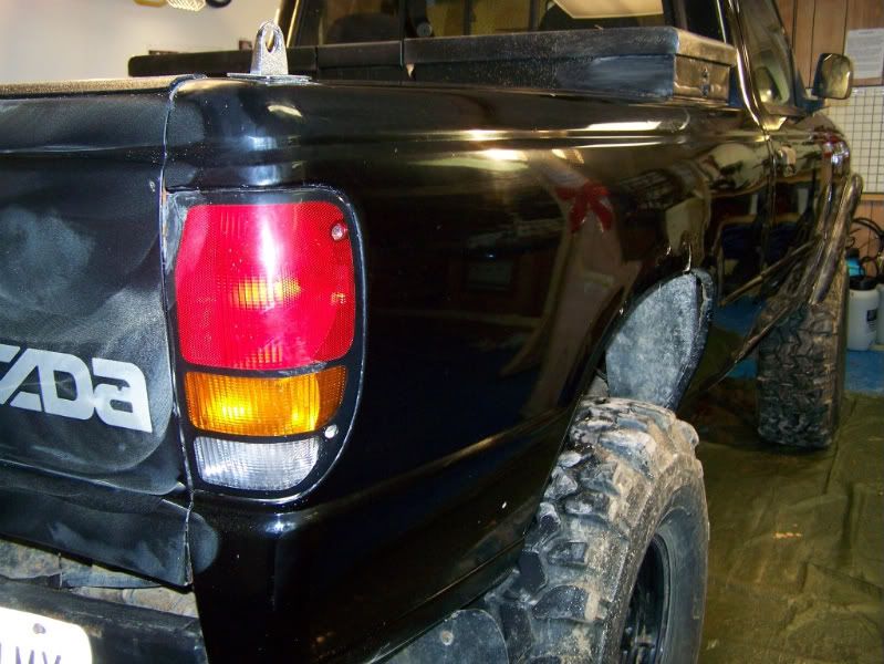

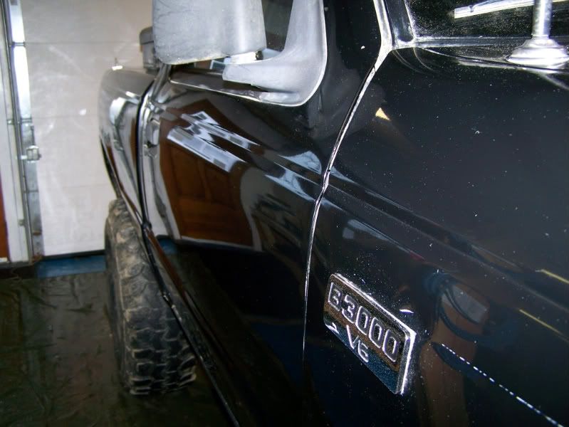

    A work in progress, but we had to start somewhere, so we chose this extremely scratched up old Mudbogger to do our first test on. Came up pretty good considering. The only thing that went wrong is the 110 burned out sending it back for a new one under warranty!

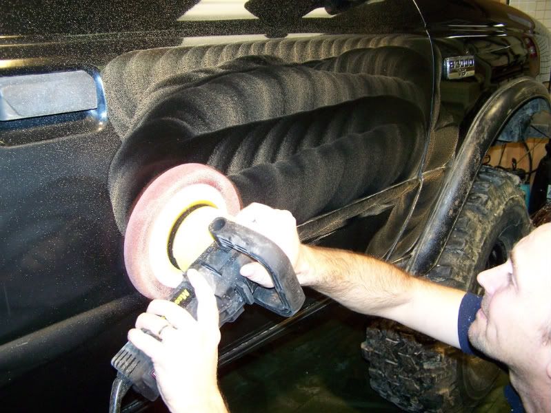

            As for the video, I had a few pointers and questions: first of all, it looks like you are covering too much area too quickly...ie arm movement speed is too high. The product needs more time to stay in one area and work - especially with a dual action polisher.
            Also, it looked like you were using a bit too much product. What product was that?
            One last pointer, if that was a polish or a compound you don't want to leave it on the truck to dry. Unlike a wax or a sealant, there is no benefit from letting a polish or compound dry on the paint - and in fact letting it dry makes it harder to remove, and you run the risk of marring or scratching during removal.
            Hope this helps!
              Even during the video I was focusing on an even, slow movement, I'll back it off even further. That was actually my first time compounding and I'm still getting used to the "runniness and splatter" from the product. You can see how it runs down the panel so easily, not like a wax. I wish it was a little thicker.
              That was Meguiar's Medium Cut Compound. I could have probably gotten away with Heavy cut for this particular truck, but I was worried the medium was going to be a bit rough.
              I actually had Heather (wife, co-owner and detailing shop foreman) to come in behind me immediately and wipe up before it got too dry. It was a good system and we finished the truck pretty quick that way. The other stuff you see on the truck is paste wax, later in the video.
              Hope this helps!
                  When using a DA, apply the product to the pad, not the panel. You would apply the product to the panel when using a rotary, or circular buffer. This will prevent the splatter, too.

                    You might want to apply your wax a bit thinner. Looks like it's kinda thick, and that's just a waste of product. Looks pretty good though!
