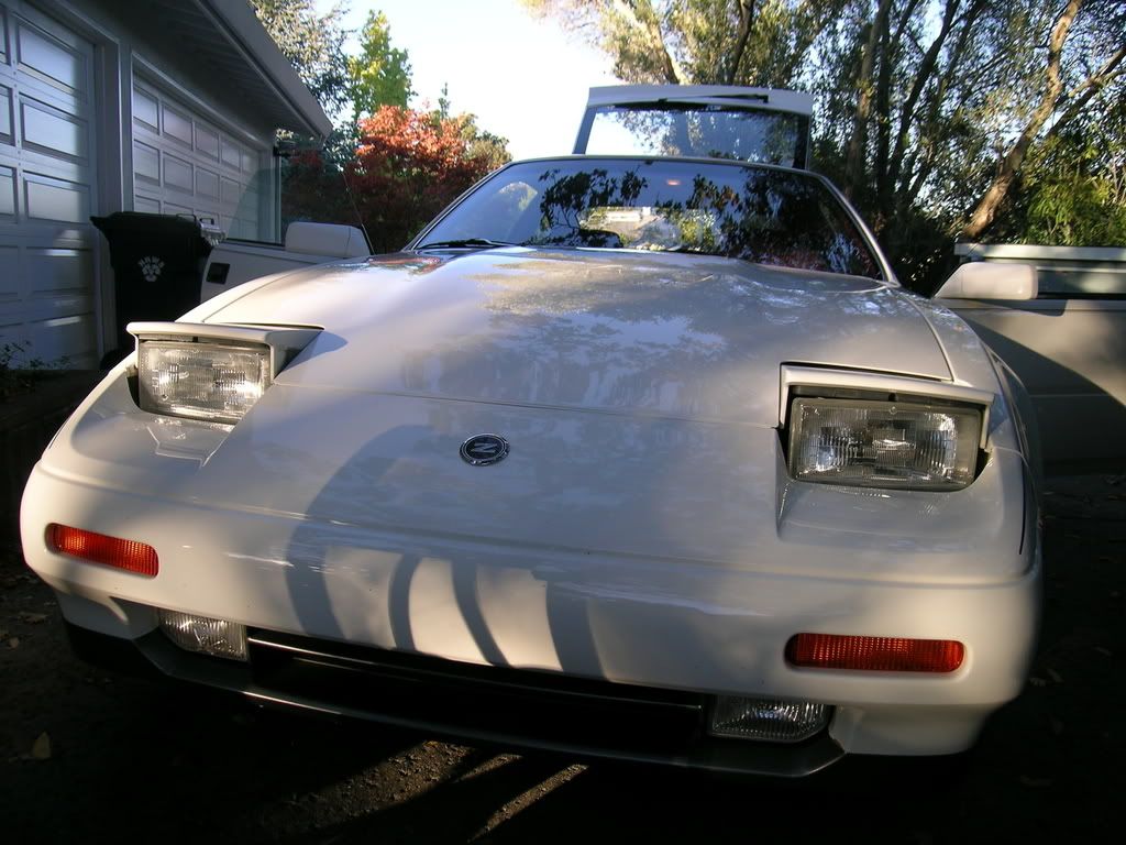

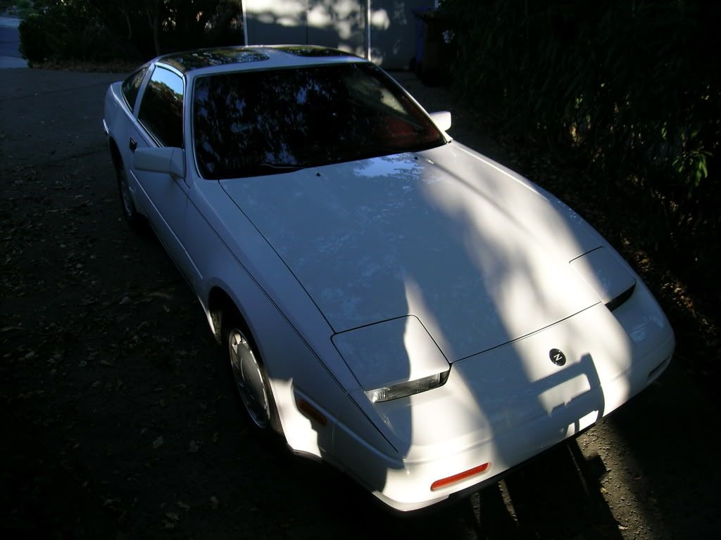

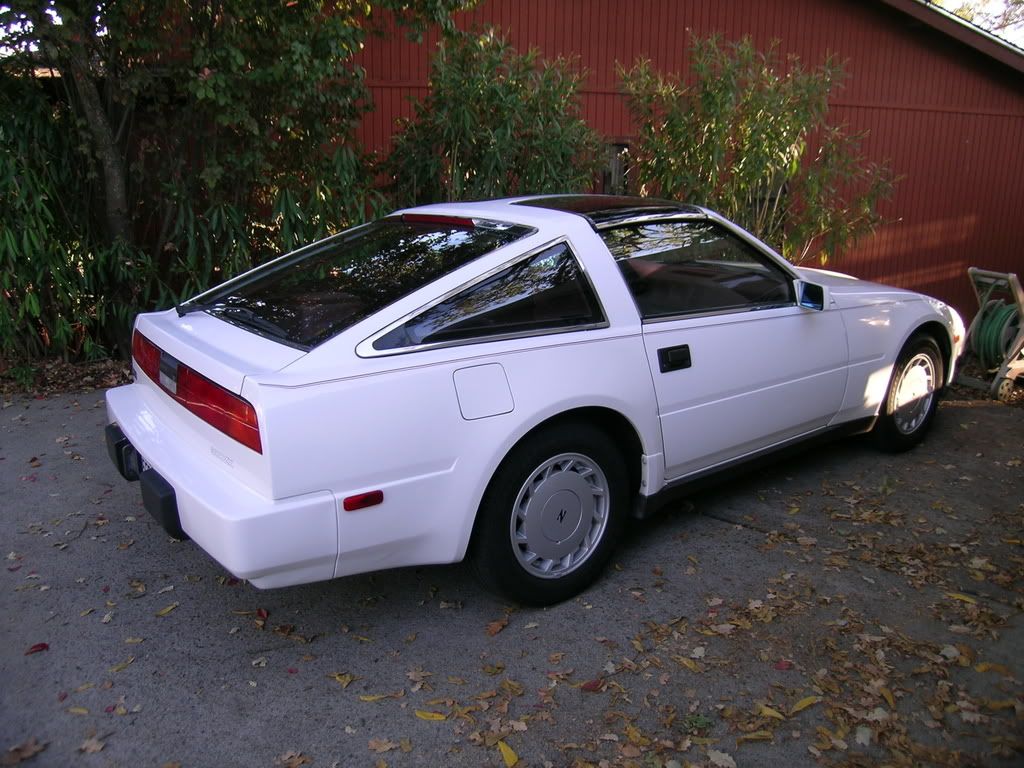

    Here's my car:
    Thanks in advance for the help.

                Your car looks good, paint looks good to.
                I would get some polish like Deep Crystal or Hand Polish.
