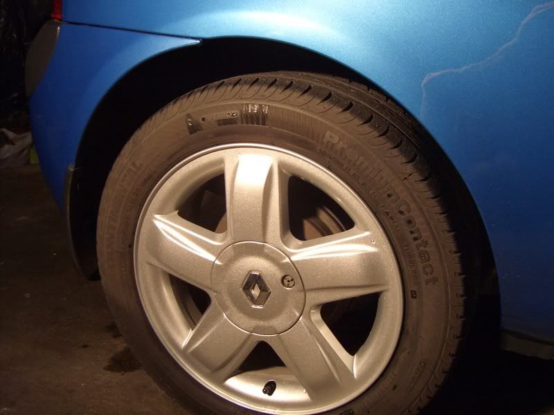

        i had a problem with my tyres turning brown last year... did it look any thing like this
        the best solution was APC (with a small amount of fairy washing up liquid to help it cling on) leave it for a min or two then re-spray and aggitate with a brush, it took 2-3 attempts but it worked.
        No Tyre Dressing - Afters

          YEP some dawn mixed with APC and scrub with a stiff brush rinse good and when dry apply your favorite tire dressing..
