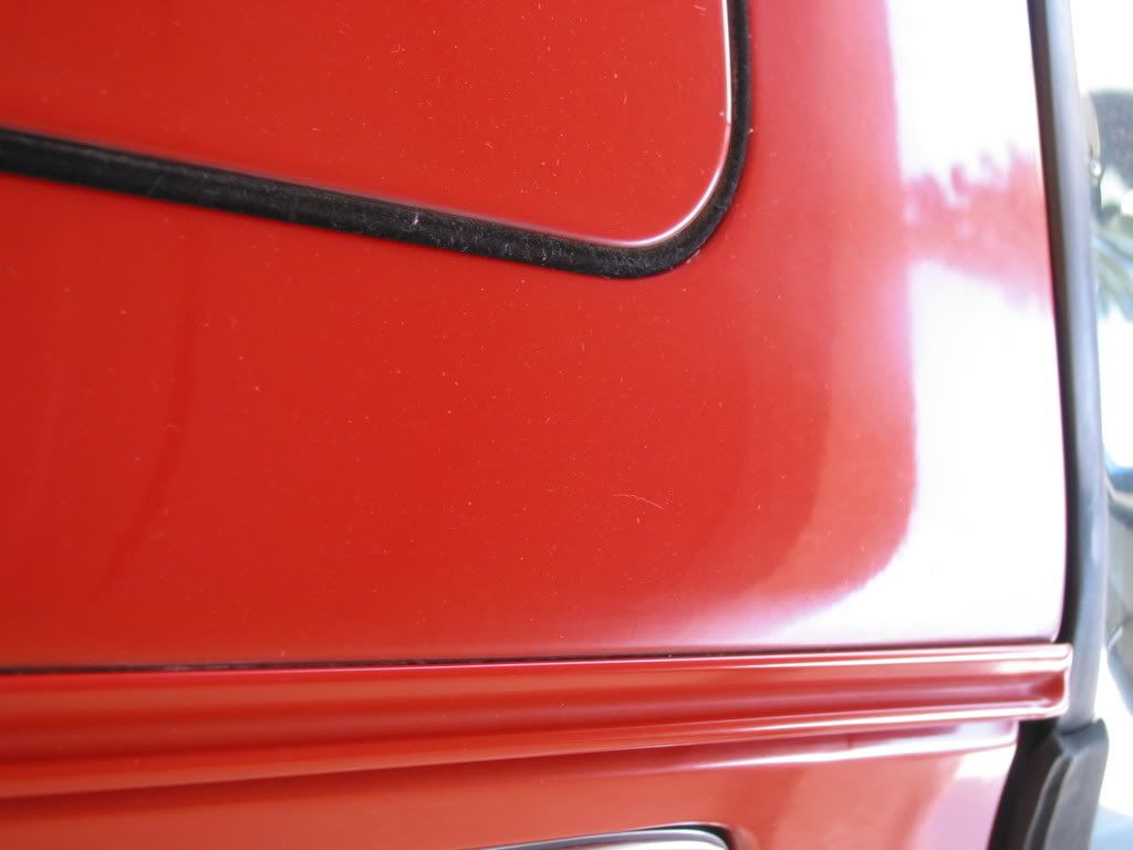

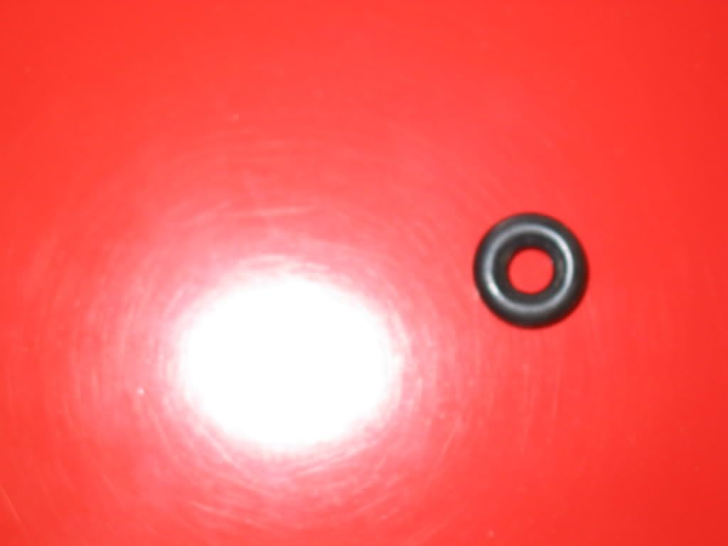

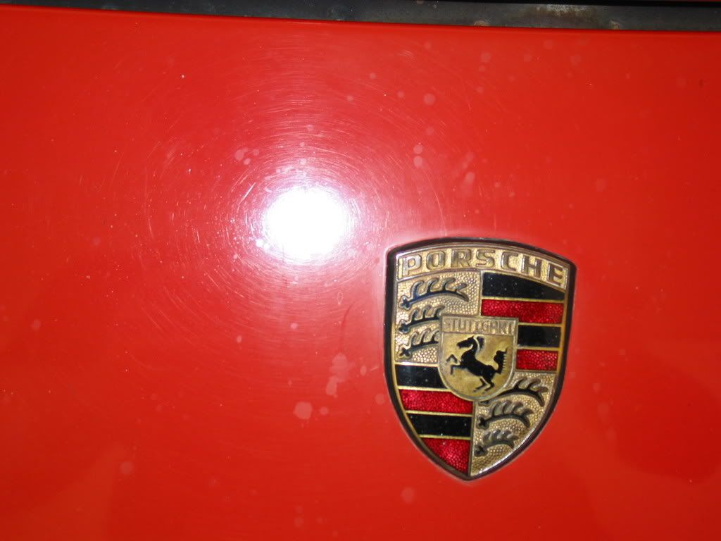

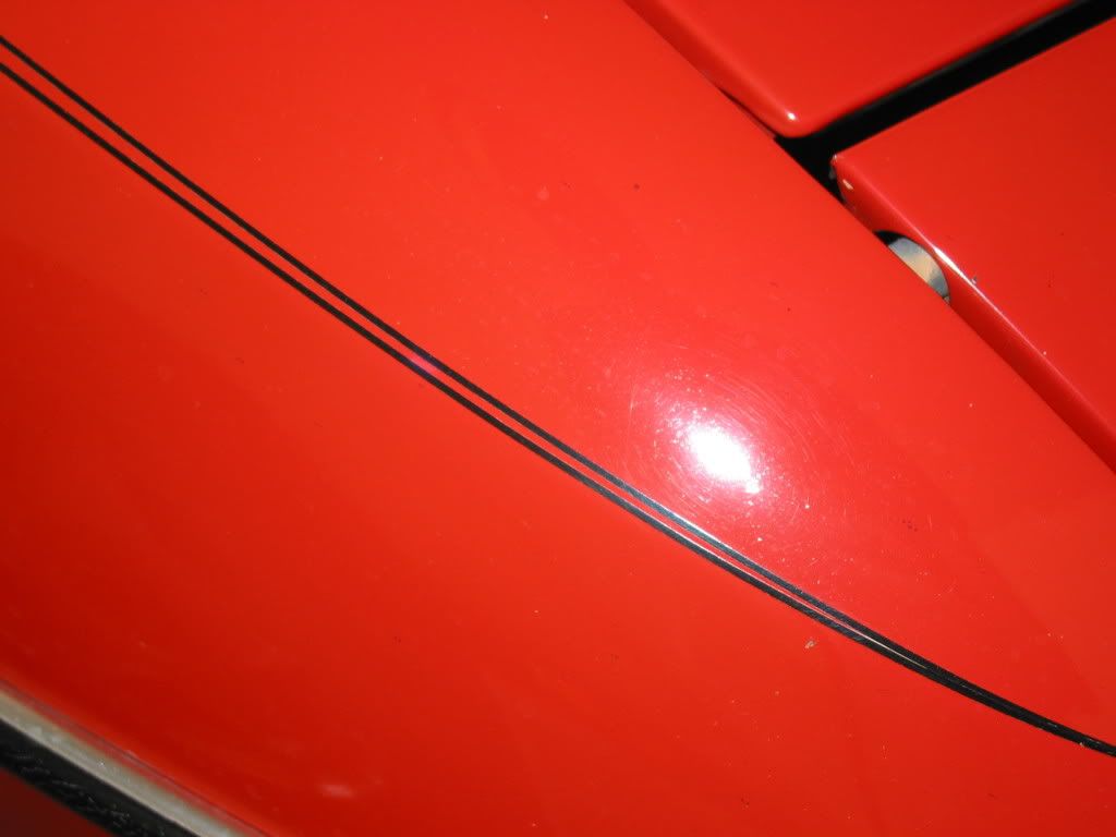

    My 1977 Porsche 924 still has it's original single-stage Mars red paint...but it is looking very swirled...and I am beginning to wonder if it can be helped at all, or if the damage is too deep to buff out...My swirls don't really look like the other swirls in pictures I have seen on this site...or maybe it's just me? LOL
    Anyway, here are some pictures of what I am talking about...I tried my best to capture the swirls...

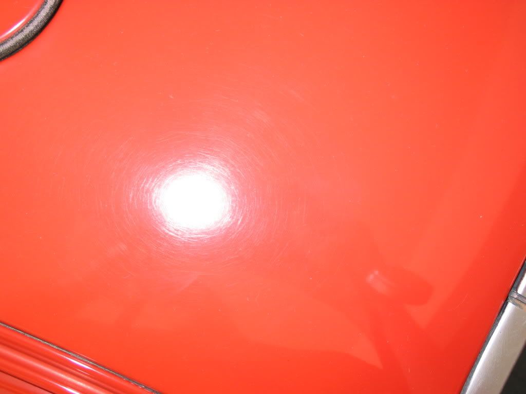

    Here you can see the swirls in direct sunlight:

    But seriously, it isnt that bad, and being single stage might polish out even easier. The chips are stuck of course, but the swirls look standard enough.
