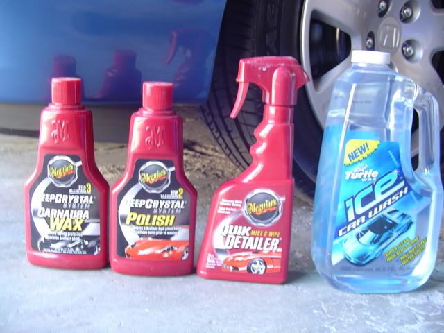

    now i recently went to a automotive store and bought a Bucket, a 12 pack of microfiber towels. Meguiars step 2 and step 3, and turtle wax ice car wash.
    now i dont really know much about keeping a car clean. I have always used dish washing soap for the cars we had. yah i know big mistake.
    now i read that polishes remove your clear coat a little to make it cleaner and remove the swirls and scratches. well wont continues polishing remove my clear coat completely or weaken it?
    Step 1 i read is non abrasive so im guessing thats good and gentle on a new car. will i still have to clay a car if i use this step? Im really hoping i wont have to because clay bars are pretty expensive. Step 2 Polish. i read it is a pure polish and therefor it just makes the paint wetter looking. Does this Polish take of some clear coat or not? Lastly Step 3 canebua wax. Dont have any questions about this product.
    ANy good info would be greatly appreciated.!! you would be my new best friend. ALso since the car is new can i dp all these steps on it right away?

    Now, as far as cleaners/polishes removing clear coat, it is all relative. You have to remember that wind blowing across the surface will remove a some molecules of paint. So, what you want to use is mild products, not strong ones.
    The 3-step products are all quite mild, and could be used weekly for years and years and years with no problems at all.
    You dont have to clay, it all just depends on what your goals, and finanical situation are.
    You can do all 3 of the steps right away to start it off looking good. Give those 3 steps a go, and then you cna always come back with more questions, look into other products in the future, etc.

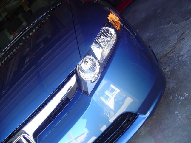

              car is new just made in march. paint is very good. but it has 3 little problems. a small half inch small scrath on rear bumper, some swirl marks on rear passanger door handle and there is a little black dot on the hood.
              Photo Sharing and Video Hosting at Photobucket
                Re: 2007 civic need HElP
                Just need the DC#1 added to your collection there for starters.
                Now, for mild swirls, D#1 is actualy too mild. You would need something more agressive like ScrachX to actualy remove/improve things.
                What it Means to Remove a Scratch
                How To Remove Swirls By Hand
                How to remove a defect by hand with ScratchX
                Not sure about what the dot would be, maybe DC#1 or ScratchX could do it, or you might need clay for that.
